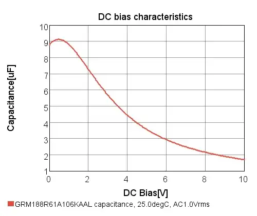

Ceramic capacitors also have a characteristic loss of capacitance with applied DC bias. For instance, the capacitance versus DC bias curve of the Murata GRM188R61A106KAAL# device is:
Murata GRM188R61A106KAAL capacitance versus DC bias
From the interactive chart, at the typical 3.3V operating input, this specific capacitor only has an effective capacitance of 5.337uF, a loss of almost 50% of the rated capacitance at under half of the rated DC bias. While the bulk capacitance of this application does not require a specific value, this can be a "gotcha" for applications with a minimum capacitance requirement.

  • Your graph is absolutely horrible! I'm looking to bypass an op amp at +/- 15V. A typical by passer is 100nF. Is this bias derating common to all ceramics, or just your small SMT type? Do we just have to use 100V rated ceramics for *old* level voltages instead? – Paul Uszak Jan 01 '17 at 14:29
    @Paul: This answer is misleading in that it picks a particularly extreme part and implies it serves as a general example. Capacitance decrease with voltage certainly exists, but there are also many cheaply available parts that react *much* better than what is shown. This is not common to all ceramics or SMD capacitors. It is a function of the ceramic. For high-volume non-exact use, like bypassing, it can be worth the little extra savings to use cheap ceramics. Better ceramics aren't that much more money, and you can also compensate by using a higher starting capacitance in some cases. – Olin Lathrop Apr 29 '17 at 13:32
