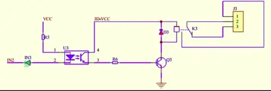

Also: these relais I thought were Solid State Relais but probably are not, since the same webshop is selling 8-relay board named as Solid State Relais as well:p. might that give me a solution? Here a link to the schematic of the relays I'm using now: schematic. (Considering that since I saw this comment in the topic linked above):

  • Hello, Uhm don't know for sure, but Isn't that the D3 diode in the picture (schematic of the relay I'm using) in transistors reply? – Bart Jun 02 '16 at 20:30

Most likely your trouble is the sudden current demand when switching on a relay is causing a glitch in your 5 V power to the Arduino and LCD. It seems as though the Arduino is keeping going but the LCD is corrupting.
Figure 1. 5 V relay board, single channel.
Just for your reference, the boards are usually operated as follows:
  • If isolated 5 V supplies are required the micro feeds the opto-isolator LED and the separate PSU powers the photo-transistor, Q1 and the relay coil.
  • Most applications have only one PSU so Vcc is jumpered to JD-Vcc.
  • When IN2 is pulled low the indicator LED and opto LED turn on. This turns on the opto-transistor which passes enough current to turn Q3 on fully. This energises the 5 V relay coil. D3 absorbs the inductive energy from the relay coil on switch-off.
Back to your problem: get another 5 V power supply - a USB phone charger and USB lead with the 'B' connector cut-off would suffice. Remove the Vcc to JD jumper and power the JD side relay board from your new supply: '+' (red) to JD, '-' (black) to common.
If this solves your problem then my theory is right. You may be able to run with one power supply provided you run wires directly from it to the relay board and directly from the PSU to the Arduino. Don't daisy chain them.
Let us know how you get on.
