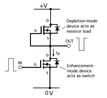

They have been used in logic ICs at a time, too (early 80's).
Basically, they were used as the high-level pass element, instead of the P-type FET now used in CMOS ICs. It acted mostly as a pull-up resistor whose value became higher when the output was low, to reduce power consumption and still having low impedance at the high-level state. Example with an inverter gate:
See the "depletion-load_NMOS_logic" Wikipedia entry.
