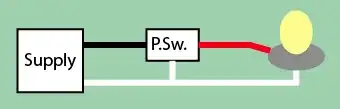

However, in many physical installations, the switch is off on a spur, fed by a 2-wire cable (supply and switched hot - no neutral present). That's outlawed as of 2011, but many installed switches are wired this way. As a result of this, many powered switches wire like this:
How do they do this? The powered switch places itself in series with the load. When on, it adds a tiny amount of voltage drop. When off, it leaks a small amount of current through the light bulb. This relied on a feature of incandescents: When cold, they resemble a dead short, and some current will flow before an incandescent starts to light.
So in fact, Off did not mean off in the past with the incandescents. Current leaked through them too. They were just so inefficient they didn't glow. LEDs are more efficient than that, and do indeed glow.
Once you screw in one old incandescent bulb in parallel with the LEDs, its "near dead short" provides a low impedance path for the dimmer's leakage current. It also greatly reduces voltage across the LEDs, so they too extinguish.
