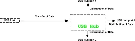

I know google's answer and wikipedia's answer for the above question. But I have a more specific question on hand. USB hubs have many incoming and port and just one outgoing port, I am able to use say n-number of devices together because of this. But, I do not understand how can one USB port do data transfers with n-number of USB ports?
how can it send different data to all USB ports at the same time?

    Pretty much the same way that your network router can connect one LAN port (the internet) to multiple devices. Each endpoint (USB device) is assigned an address, and the hubs simply route requests from the host to the correct device by keeping track of what address is on what port. It's much simpler for USB in the sense that there is only one master (the host port) which initiates all of the transactions. – Tom Carpenter May 29 '16 at 03:34
  • @TomCarpenter Then How would the USB port send different data's together? – Aaditya Sahay May 29 '16 at 03:35
    The host port asks a specific endpoint to talk. Endpoints only talk back when asked to by the host. – Tom Carpenter May 29 '16 at 03:36
  • @TomCarpenter But they all are being used simultaneously and not one by one, but all together. – Aaditya Sahay May 29 '16 at 03:37
    Remember that the USB bus can run at up to 480Mbps on USB 2.0. The host only ever talks to one endpoint at a time, but it talks to all of them sequentially and switching between them so fast you couldn't tell. The same thing networks do. "Hey, mouse on port 1, tell me if you've moved. Ok now keyboard on port 2 have you got any key presses to report? Now you there on port 3, flash drive, store this data for me. Anyone else I need to talk to? nope, ok then, mouse on port 1, tell me if you've moved..." – Tom Carpenter May 29 '16 at 03:40
  • @TomCarpenter Thanks, that was one good explanation. The port is so fast that it feels lag free. Interesting technology. Can you post it as an answer for the community may be? – Aaditya Sahay May 29 '16 at 03:42
