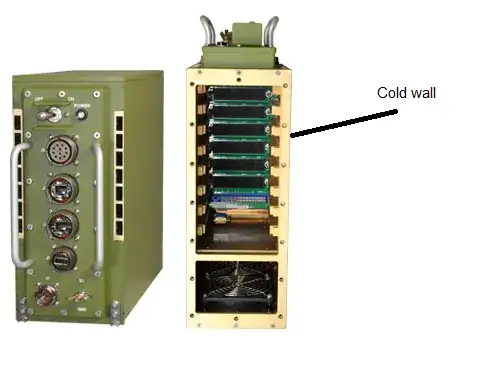

In response to the comment on card edge temperatures, here is a typical conduction cooled chassis:
Conduction cooled chassis
The outer part of the chassis is known as a cold wall (where we can know the temperature) and it may simply be metal or have other methods of maintaining a reasonably well known temperature.

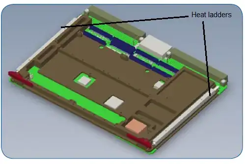

Now here is a typical card, with heat ladders:
Conduction cooled card
These are often made of aluminium (it is cheap and has decent thermal parameters) and the ladders are in contact with the side edges of the enclosure above; as there will be some heat differential between the outside and inside of the box, the temperature withstanding requirement for the PCB is set at this internal heat ladder, which is, as you can see at the card edge.
As the heat must get from the components to this point, it is not unusual for the PCB at a hot component (such as a processor or GPU) to get to 95C or more with a card edge temperature of 85C (which is often a specific requirement).
The thermal resistance of most flavours of FR-4 is \$0.4 \frac {W} {mK}\$ so lots of internal metal layers will exist in this type of card.
In some situations, we may need to use thermally clad PCBs which although expensive may be the only way of getting the heat out.
