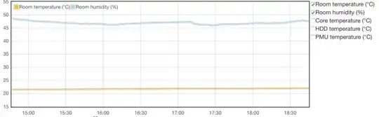

From the software mentioned in the question, the fastest seems to be lol_dht22. I am using a slightly changed version of it (by myself), that creates files in /var/run aprox every 9-10 seconds to feed rpimonitor.
temp
As @ChrisStratton correctly says, this method of bit banging/polling is highly prone to errors, especially when running in user land.
The simple protocol checksum implemented by the DHT21 is clearly not strong enough to weed out most of the errors/spikes (and there are many). I had to add simple software correction routines to ignore out of place values, and even then there are spikes.

graph
