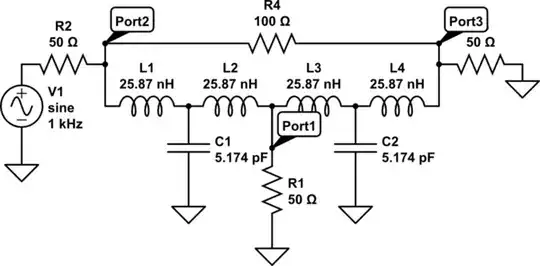

I haven't worked out all of the math details, but I think it's going to be possible to show that if power is injected at Port 2, half of it flows through the resistor toward Port 3, and half flows down the transmission line to Port 1.
At Port 1, this power divides further, sending 2/3 of it out Port 1, and the other 1/3 down the other transmission line to Port 3.
At Port 3, the power through the resistor is attenuated by voltage divider action against the net impedance at that port. The power through the transmission line is transformed in impedance and goes through a similar voltage divider action when it arrives at Port 3, but since it has been delayed by 180° it cancels the resistor power.
Again, I haven't written out the full equations yet, but it seems like it should work out.
In any case, this simulation shows the effect rather clearly. Just for variety, I used T networks (rather than your π networks) as transmission line simulators. The component values were selected to have reactances of 70.71 Ω at 435 MHz. There is a deep dip in the power delivered to Port3 at that frequency, and equal amounts of power are being dissipated in R1 and R4.

  • Dave, I agree with everything you said except for a clarification. You say "... if power is injected at Port 2, half of it flows through the resistor toward Port 3..." Half the power is delivered to the resistor, BUT it is delivered in both directions since there is voltage on either end of the resistor. – Andrew W. May 19 '16 at 23:30
  • @AndrewW.: I hope we're not talking past each other here because of a confusion in terminology. The current through the Port1-Port3 transmission line exactly matches the current through the resistor (R4), so there is not in fact any voltage at Port3. – Dave Tweed May 19 '16 at 23:42
  • I believe we are. No power leaves port 3 because the voltage across the resistor (R4 in your schematic) cancels with the voltage wave initiated from port 2. – Andrew W. May 20 '16 at 04:56
