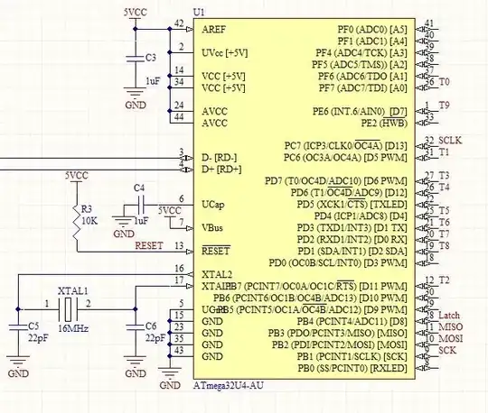

To compare intupt voltage and to do some action until cap has still charge

    I get the idea (although that schematic won't work as is; output is always high). On the BeagleBone Black there is a PMIC that integrates this, and seems to have the _capability_ to generate a NMI, that _could_ be made to back-up data and sleep. But Linux, and the eMMC, are complex beasts; I do not even know how much time it takes for the eMMC to safely finish the last write! – fgrieu May 18 '16 at 11:36
    @fgrieu It was just an idea, I am just looking at TPS65217C. The entire kernel should be patched to finish the actual write procedure in eMMC and then sleep, but also when it wakes up. A NMI is more usefull to wakeup (IMO), rather than the signal of supply outage - this can be queried each scan and change action, like disable some periphereals and wait until write is complete. – Marko Buršič May 18 '16 at 11:54
