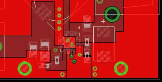

  • The Sparkfun pad uses a solder-paste jumper to connect the pads. With certain manufacturing processes, it will work just fine. – Kevin Vermeer Dec 29 '11 at 18:40

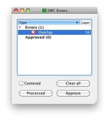

Create a footprint with GND and AGND pads. Draw copper between these pads. Yes, this will produce a DRC "Overlap" error as shown below:
DRC "Overlap" error in errors dialog
This is OK. There three buttons at the bottom:
  • Clear all
  • Processed
  • Approve
"Clear all" will temporarily clear the list for this run of the DRC. I'm not sure why that's useful; just close the window if you want it shortened.
"Processed" will fade out the color of the red X. This is potentially useful if you're iterating through a long list of DRC errors and fixing them as you go; you can keep track of the ones you think you've corrected.

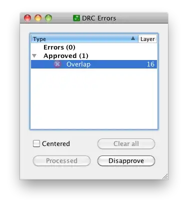

"Approve" is the only one I use on a regular basis. This moves the error from the errors list to the approved list:
Error moved to approved list in errors dialog
and keeps it there on subsequent runs of the DRC. Note that this only moves this specific error with this specific pair of nets at this specific location. Closing this window and running the DRC again produces the notification "DRC: 1 approved errors"
and no "DRC Errors" dialog. You can get this dialog back by creating an error, or (preferably) the errors command, the yellow exclamation point in the above screenshot, or the menu Tools -> Errors.

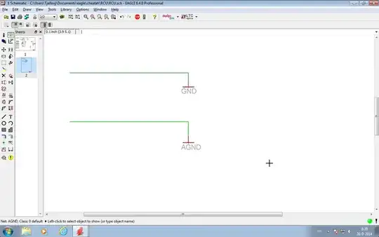

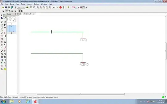

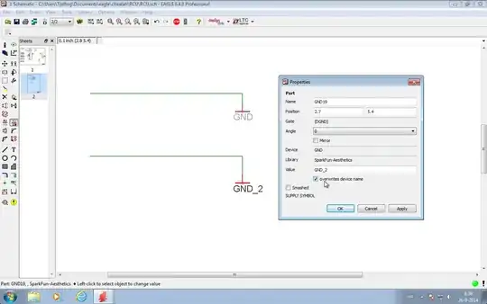

A bit late but still, here is how to do it:
To get 2 different grounds is simple. Add a ground symbol in your schematic, then give it a new value. Now go to the properties of that ground symbol and an extra option will be available which says 'overwrite device name'. Uncheck that option.
Now draw a net wire to the ground symbol and name that wire AGND for example. Now your ground symbol will have the same net name. Now give your ground symbol a value again that says AGND to make it a bit more clear that that ground is AGND and not the other ground for example.
Below are some images to make it bit more clear. Look at the bottom left of the screen for signal names so you can see that it works.
look at the signal name at the bottom left of the screen
again look at the signal name at the botton left of the screen
