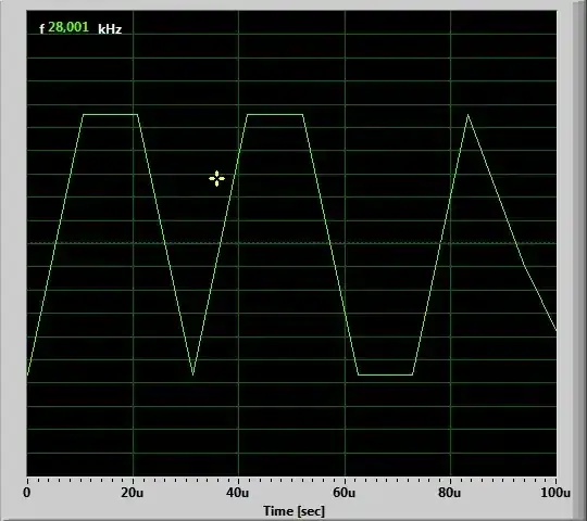

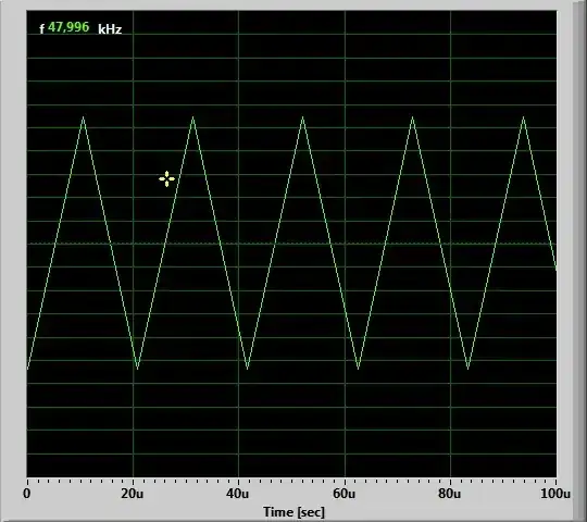

I don't have much theory to post, but I think that the following screenshots may help illustrate the problem. We're seeing square waves at various frequencies as seen by a Realtek ALC 268 sound card with 16 bit resolution and 96 kHz sample rate. The sound card example here is done on purpose because sound cards have very limited input capabilities.

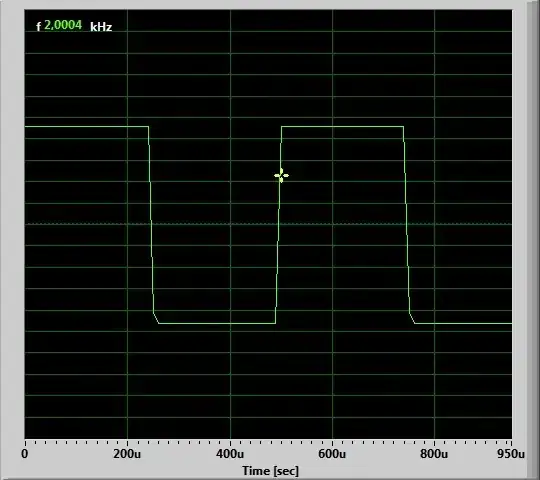

Next we have 2 kHz: 2 kHz square wave
Here we see a bit of distortions.

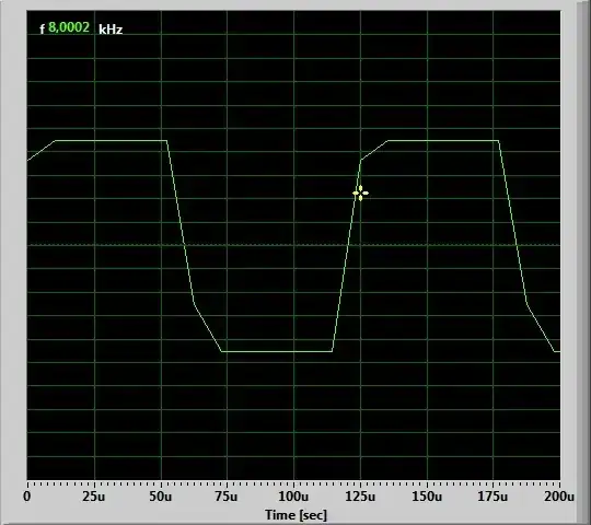

Next we have 8 kHz:
8 kHz square wave
Distortions here are obviously visible.

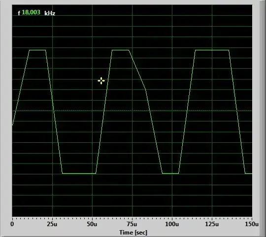

18 kHz:
18 kHz square wave
Even more distortions and the square wave is slowly starting to look triangular.

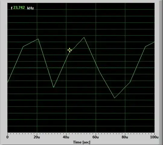

Here we have 28 kHz:
28 kHz square wave
We're getting spikes now.

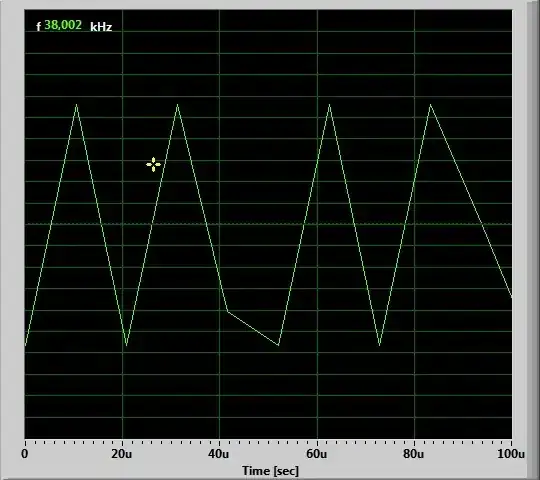

38 kHz:
38 kHz square wave
It's even worse now. We're losing the flat bottom of the signal.

48 kHz:
48 kHz square wave
We're at half of the sample rate now and the frequency is getting bad.

  • Is this caused by the large frequency content of a square wave? A 45Hz sine wave sampled by this card could be reconstructed, at least theoretically. – Astrid Dec 11 '11 at 13:59
  • @Astrid I'm not sure. Could be. I'll do some research and see if I can find something out. Also I don't think it's actually relevant. In general case, you're using scope to see the signal which shape isn't known to you. You can of course expect a certain signal, but the scope is there to show what is actually happening and beyond a certain point the clear picture is lost. Basically same thing from tyblu's answer, section 1.4. – AndrejaKo Dec 11 '11 at 14:48
  • You bet, @Astrid. The 48kHz example is basically at the Nyquist frequency, and, if reconstructed with sinusoidal interpolation instead of linear, would show a 48kHz sinusoid. The 60kHz example would be reconstructed as an alias of 96kHz and 60kHz: a 36 kHz sine wave. – tyblu Dec 12 '11 at 00:14
