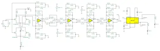

here below i have the schematic and results obtained,and the results were not at all up to the mark as expected in the comments
schematic: enter image description here

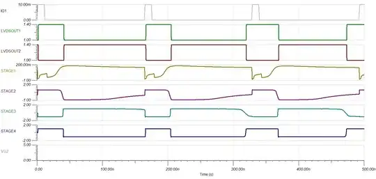

10nA input perfectly output is preserved enter image description here
1uA input enter image description here
1mA input enter image description here
my simulator shows me some noise analysis results which looked impressive, but i have to find out how they are calculated
At the end the pulse width is not all maintained, my current implementaion failed due to saturation of opamp i believe, any how doors open for the comments and criticism

2 - I am astounded that you're getting acceptable results over this dynamic range. Running a TIA to give 50 mV for 10 nA will produce 500 kV for 100 mA, and frankly I'm having problems believing that you have designed and built a TIA with that sort of clipping/overload performance. You also have an effective transimpedance of 5 Mohm. Granted that you're using a much lower transimpedance followed by voltage amplification, getting adequate speed in this setup is not something I'd want to try, and the dynamic range of the output chain remains at wildly improbable levels. Assuming, just as a SWAG, 1 nsec rise and fall times, a perfectly compensated TIA with a single pole response will need 350 MHz bandwidth, rather than 100 MHz, and the subsequent amplifiers will also need that bandwidth or better. I suggest that you take a long hard look at your test setup, from your test emitter all the way down, and make sure you're not fooling yourself about your results.
3 - I also don't think I believe your results on the basis of noise. Assume, just for instance, a 10k feedback resistor on your TIA. This will boost a 10 nA pulse to 100 uV. At the same time, Johnson noise from the feedback resistor combined with a 350 MHz bandwidth will give you 240 uV rms noise, which is not what I call a good SNR for measuring pulse width. Note that going to a 1k resistor gives 10 uV signal and 75 uV rms noise, so you want your transimpedance as high as possible. This, of course, will bang head-on with your amplifier speed and stability.
Like I say, I'm very skeptical about your claimed performance. Unless you post a detailed circuit showing how you got it, I think you're kidding yourself.

  • 1. i thought people will raise this, the dynamic range is in respect to photo diode not TIA, 2. you are right, but i am using a current protection(under eval) i wont let a 100mA to pass to TIA even 3. i have a noise suppression using differential FET pair as like one suggested by bob http://electronicdesign.com/analog/whats-all-transimpedance-amplifier-stuff-anyhow-part-1, through which i can reduce noise up to few uV, as soon as i complete circuit fully i would post it, my main concern is dumping my present approach and choosing a new one, by the way the OPA i am using is LHM6629 4stages, – kakeh May 13 '16 at 04:41
  • @WhatRoughBeast. I agree with your synopsis, but will not vote until the OP has reviewed and revised his circuit. Something is not right here, or the OP has found a 'perfect' TIA. –  May 13 '16 at 04:41
  • @kakeh - Dude, I admire your cojones, but following Bob Pease's advice scaled up to sub-GHz frequencies is not remotely simple. Commercial FETs that work at 1 nsec around an op amp loop? Are you kidding? Furthermore, your op amp current noise over this bandwidth is going to be nearly 50 nA rms which is not what you call compatible with your 10 nA pulse amplitude. Again, unless you provide a schematic, I will remain deeply, deeply skeptical. – WhatRoughBeast May 13 '16 at 04:53
