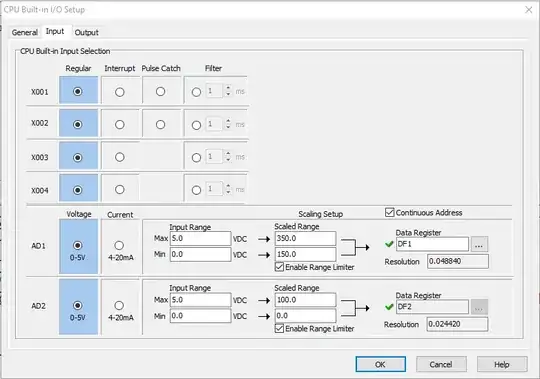

The first thing is to scale the input. Some PLCs such as Allen Bradley's have instructions for doing this, but the CLICK makes this easier using a graphical editor. Here it is;
Click PLC analog input scaling
The temp input signal is connected to input AD1 (analog to digital). We select 0-5V option. For scaling we set 0V = 150deg F and 5V = 350deg F (since 25mV = 1 degree).
5V = 5000mV
5000mV/25mV = 200
150 + 200 = 350
The scaled input is saved in memory register DF1 which is a 32 bit floating value address.
