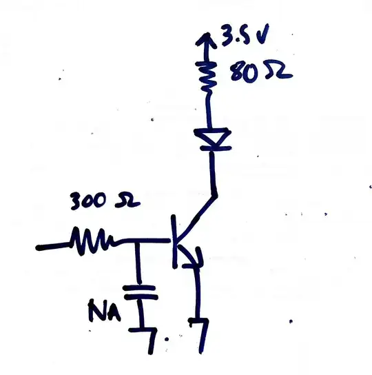

I have a simple NPN switch, see the diagram.
I feed a 100KHz square wave (TTL) to the base of this transistor and it turns on very very fast (a few nSec) but it doesn't turn off as fast, it almost takes 2uSec for it to turn off. (I am looking at the collector of this circuit). The diode is a laser, transistor is run off the mill NPN (datasheet). I also tried with another NPN from ONSemi which is faster (at least what I think) same story.
Why the transistor doesn't turn off as fast?
How can I make it turn off in a few nSec?
Is it better to use a MOSFET than NPN in this case?
Schematic showing a simple NPN switching circuit
** UPDATE **
I have added a 1K instead of that NA capacitor pad and use a faster BJT, things improved a bit. (Actually, I found that the BJT is similar speed but lower collector output capacitance, 2pF vs. 6pF). Anyway, now I see turn off about 120nSec. I will add a speed up cap and report results from here.

    What's with the capacitor? – Majenko Dec 07 '11 at 08:37
    @Majenko pls ignore it, it is not connected, hence the NA notation. I put there because somebody could suggest put a resistor there or add a cap there etc. – Frank Dec 07 '11 at 08:47
  • @Frank Why isn't there a resistor at capacitor's place? – AndrejaKo Dec 07 '11 at 08:49
  • @AndrejaKo that resistor is not so important in my case since I either pull high or low, never unknown state. The resistor in place of that cap is usually make the state known, I am not aware of any other purpose. – Frank Dec 07 '11 at 08:51
  • @Frank Some answers here suggest otherwise. I'll see if I can dig them up. – AndrejaKo Dec 07 '11 at 08:53
  • @Frank [Here](http://electronics.stackexchange.com/a/16147/12400)'s one. – AndrejaKo Dec 07 '11 at 08:54
  • @AndrejaKo I will put 1K and see what happens.. Will let you know shortly. – Frank Dec 07 '11 at 09:01

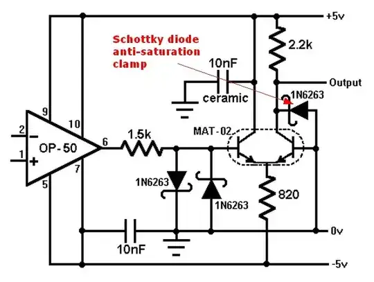

  • Anti saturation Schottky clamp
  • Speedup capacitor.
  • (1) Connect a small Schottky diode from base to collector
    (Anode to base, Cathode to collector), so that the diode is reverse biased when the transistor is off.
    When the transistor is turned on the collector cannot fall more than a Schottky "junction" drop below the base. The transistor this cannot go into saturation and charge accumulated is much smaller so is quicker to get rid of on turn off. Example of this from here
Look at the internal block diagrams for Schottky TTL. Note how this compares. This is primarily what allows Shottky TTL to be faster than standard TTL.

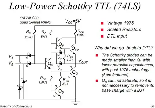

LSTTL & even faster friends:
Warning !!!!!!!!!!!!
Looking in here whence the below diagram came from, is liable to result in you and your soldering iron and/or breadboard staying awake all night :-).
Many good ideas.
Can you do a Miller killer ? :-).
Note that low power Schottky uses Schottky diodes whereas the earlier Schottky TTL used Schottky transistors - an apparent step backwards.

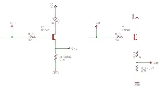

I suppose your problem is, that your BJT is saturated when switched on. This means the current going through the collector is NOT limited by the control current going through the base but by the current limiting resistor in the collector path.
I.e. with the same base current the transistor could admit more current going through the collector.
If this is the case, the turn off time of the transistor will be relative long (if I remeber right, the reason is because then charges in the base region will be swept out mainly by diffusion which is a rather slow physical process).
You can change this situation easily by following circuit:
Now the current going through the emitter (which is only slightly more than the one going through th collector) will raise the emitter to a level that makes the base current just small enough that it will be the limiting factor of the current going through the collector. So the transistor wont be saturated any more and will turn off quicker.
There is also another advantage of this circuit:
This circuit will be more stable when the transitor heats up and becomes more conductive (semiconductors become MORE conductive when heated). The current wont change much (in your first circuit it will).
Be aware that the current now doesn't depend on the supply voltage, but on the control volatge (Vin).
EDIT1:
Let be
Rb resistor at base (may be a small value; even 0 Ohms)
Re resistor at emitter
Vbe base-emitter-voltage (ca. 0.7 V for Si transistors)
b current amplification (ca. 50..100)
Ie = b*Ib emitter current; almost equalt to Ic = Ie - Ib
Vin = Rb * Ib + Vbe + Ie*Re
Solve for Ie:
Ie = ( Vin - Vbe ) / ( Rb/b + Re)
Rb/b will be very small; can be negelegted, so
Ie = ( Vin - Vbe ) / Re
EDIT2:
I did some real world measurements of both circuit variants:
The left version is the one with the saturated transistor (A).
The right version is the one with non-saturated transistor (B).
In both variants the switched current is about the same.

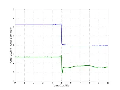

But now look how long it takes to turn off the current in (A):
ca. 1.5µs between the edge of CH1 (base voltage; blue) and CH2 (emitter current; green): enter image description here

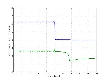

...and in (B):
almost no delay between the edge of CH1 (base voltage; blue) and CH2 (emitter current; green): enter image description here

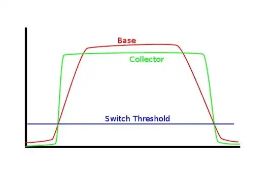

The problem here is the asymetric nature of a BJT's switching.
If the switching threshold is less than half way between the minimum and maximum base voltage then the transistor will take less time to switch on than switch off. If it is over half way it will switch off faster than it switches off.
For example, take a look at this over simplified graph I have scribbled out:
As you can see, as the base voltage rises above the switch threshold the transistor switches on. It stays on until the base drops down below the switch threshold again. As this is below the halfway point it takes longer for that base voltage to reach the switch threshold than it did when switching on.
By adding a resistor between the base and ground you create a voltage divider. This reduces the range of the base voltage to bring the base voltages closer to symmetry around the switching threshold.
When running as an amplifier, you aim to fit the base voltages into the switching zone, so that the transistor is never either fully on or fully off, but is being manipulated around that tight switching zone.
Disclaimer: Yes, I know this is overly simplistic, but it gets the basic principle across without bogging the OP down with mathematics and formulæ.
