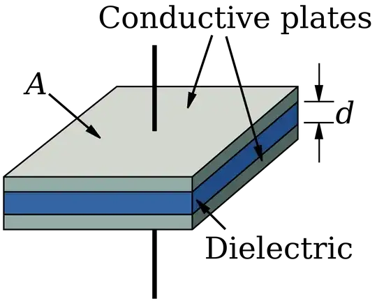

1. Capacitors
There are a lot of misconceptions about capacitors, so I wanted to briefly clarify what capacitance is and what capacitors do.
Capacitance measures how much energy will be stored in the electric field generated between two different points for a given difference of potential. This is why capacitance is often called the 'dual' of inductance. Inductance is how much energy a given current flow will store in a magnetic field, and capacitance is the same, but for the energy stored in an electric field (by a potential difference, rather than current).
Capacitors do not store electric charge, which is the first big misconception. They store energy. For every charge carrier you force onto one plate, a charge carrier on the opposite plate leaves. The net charge remains the same (neglecting any possible much smaller unbalanced 'static' charge that might build up on asymetrical exposed outer plates).
Capacitors store energy in the dielectric, NOT in the conductive plates. Only two things determine a capacitor's effectiveness: its physical dimensions (plate area and distance separating them), and the dielectric constant of the insulating between the plates. More area means a bigger field, closer plates mean a stronger field (since field strength is measured in Volts per meter, so the same difference of potential across a much smaller distance yields a stronger electric field).
The dielectric constant is how strong a field will be generated in a specific medium. The 'baseline' dielectric constant is \$\varepsilon\$, with a normalized value of 1. This is the dielectric constant of a perfect vacuum, or the field strength that occurs through spacetime itself. Matter has a very large impact on this, and can support the generation of much stronger fields. The best materials are materials with lots of electric dipoles that will enhance the strength of a field generated within the material.
Plate area, dielectric, and plate separation. That's really all there is to capacitors. So why are they so complicated and varied?
They aren't. Except the ones with much more than thousands of pF of capacitance. If you want such ludicrous amounts of capacitance as we mostly take for granted today, such amounts as in millions of picofarads (microfarads), and even order of magnitudes beyond, we are at the mercy of physics.
Like any good engineer, in the face of limits imposed by the laws of nature, we cheat and get around those limits anyway. Electrolytic capacitors and high capacitance (0.1µF to 100µF+) ceramic capacitors are the dirty tricks we used.

3. Ceramic Capacitors
Ceramic capacitors use a ceramic as their dielectric, with metallization on either side as the plates. I will not be going into Class 1 (low capacitance) types, but only class II.

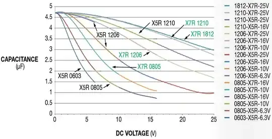

Class II capacitors cheat using the ferroelectric effect. This is very much akin to ferromagnetism, only with electric fields instead. A ferroelectric material has a ton of electric dipoles that can, to some degree or another, be oriented in the presence of an external electric field. So the application of an electric field will pull the dipoles into alignment, which requires energy, and causes a massive amount of energy to ultimately be stored in the electric field. Remember how a vacuum was the baseline of 1? The ferroelectric ceramics used in modern MLCCs have a dielectric constant on the order of 7,000.
Unfortunately, just like ferromagnetic materials, as a stronger and stronger field magnetizes (or polarizes in our case) a material, it begins running out of more dipoles to polarize. It saturates. This ultimately translates into the nasty property of X5R/X7R/etc type ceramic capacitors: their capacitance drops with bias voltage. The higher the voltage across their terminals, the lower their effective capacitance. The amount of energy stored is still always increasing with voltage, but it is not nearly so good as you would expect based on its unbiased capacitance.
Voltage rating of a ceramic capacitor has very little effect on this. In fact, the actual withstanding voltage of most ceramics is much higher, 75 or 100V for the lower voltage ones. In fact, many ceramic capacitors I suspect are the exact same part but with different part numbers, the same 4.7µF capacitor being sold as both a 35V and 50V capacitor under different labels. The graph of some MLCCs' capacitance vs. bias voltage is identical, save for the lower voltage one having its graph truncated at its rated voltage. Suspicious, certainly, but I could be wrong.
Anyway, buying higher rated ceramics will do nothing to combat this voltage related capacitance falloff, the only factor that ultimately plays a role is the physical volume of the dielectric. More material means more dipoles. So physically larger capacitors will retain more of their capacitance under voltage.
This is also not a trivial effect. A 1210 10µF 50V ceramic capacitor, a veritable beast of a capacitor, will lose 80% of its capacitance by 50V. Some are a little better, some are a little worse, but 80% is a reasonable figure. The best I have seen was a 1210 (inches) keep about 3µF of capacitance by the time it hit 60V, in a 1210 package anyway. A 10µF 1206 (inches) sized 50V ceramic will be lucky to have 500nF left by 50V.
Class II ceramics are also piezoelectric and pyroelectric, though this doesn't really impact them electrically. They have been known to vibrate or sing due to ripple, and can act as microphones. Probably best to avoid using them as coupling capacitors in audio circuits.
Otherwise, ceramics have the lowest ESL and ESR of any capacitor. They're the most 'capacitor-like' of the bunch. Their ESL is so low that the primary source is the height of the end terminations on the package itself Yes, that height of an 0805 ceramic is the main source of its 3 nH of ESL. They still behave like capacitors into the many MHz, or even higher for specialized RF types. They also can decouple a lot of noise, and decouple very fast things like digital circuits, things electrolytics are useless for.

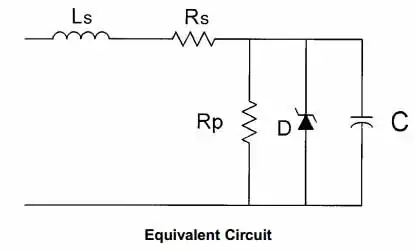

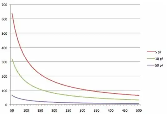

The three main types have differing characteristics - I suggest you do some research on them but the main things to look for are
  • self-resonant frequency (brought about by the effective series inductance). Simple example shown below: - enter image description here
  • dielectric losses (usually at high frequencies): -
  • effective series resistance (more losses)
  • change in capacitance with voltage applied (not good for filters): -
  • change in capacitance with temperature (also not good for filters): -
  • initial tolerance expectations

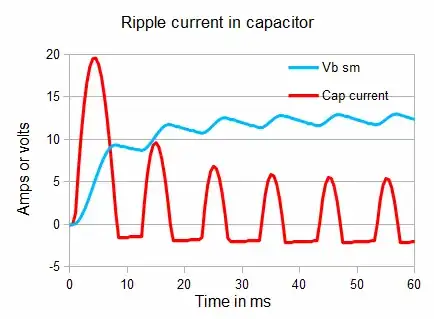

  • ripple current (important for power supplies due to high peak demands): -
  • Ability to avoid going short circuit (X and Y capacitors)
  • Low microphonics (important in sensitive audio applications). Here's a guy who knows about it: -
  • Basic electrolytic caps are polarized hence AC applications are restricted. Here's the equivalent circuit: -
I'm sure there are a few other things but these will become apparent during your investigation.
