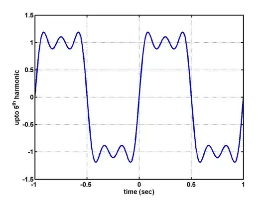

square wave first 5 harmonics
In the image, the square wave is truncated by considering terms only up to the fifth harmonic, which is exactly the kind of behavior I would expect to be the output signal of a system that attenuates higher frequencies.
Now, why is the output the first wave, instead of the second wave? Does this happen because the low pass filter just logarithmically attenuates the signal, instead of act like a perfect ideal low-pass filter? (By perfect low pass filter, I mean a filter that would keep exactly the same gain over the signal until a certain frequency, and for higher frequencies would have a zero gain, like in the image below)

  • My father used to say "solve the differential equation and see". The first image is correct, and the other image is correct. Play with frequency of the square wave and see both options. –  May 06 '16 at 05:56
  • https://en.wikipedia.org/wiki/Gibbs_phenomenon – user57037 May 06 '16 at 05:58
    The 1st example is 1st order LPF, while the second is n-order LPF. – Marko Buršič May 06 '16 at 06:17
    Yeah, the cut-off frequency you chose is too low, so you cut harmonics close to the fundamental which is why you don't get the square wave with smooth edges. – lucas92 May 06 '16 at 17:24

The second waveform can be formed by additive superposition of sinusoidal signals: odd harmonics which are in phase. Alternatively, it can be the result of a filter applied to a square wave. But that filter isn't an impulse response filter. Rather, it is a filter whose output, at every point, is based on surrounding points. That is to say, future and past values of the signal. These surrounding values are weighted symmetrically. This is why the smaller "humps" appear nice and symmetric.

The second curve (if taken as the result of filtering a square wave) is a very high-order filter. It is able to let through several low frequency components and then strictly cut everything above. If it weren't a high order filter, it could also produce a waveform with sharp artifacts due to high frequencies not entirely being attenuated.
The skewing or symmetry can also be understood or regarded as an effect of phase. The impulse response filter applies a phase shift to the signal, but the phase shift is frequency dependent. The very low frequencies, far below the "knee", which pass through the filter aren't phase shifted. Frequencies which are heavily attenuated are also phase shifted by up to ninety degrees. And of course, what "ninety degrees" means (in terms of absolute duration or wavelength) is frequency-dependent, too. This frequency-dependent phase shift correlates with the skewed shape. The "ideal" symmetric waveform you see in your second example is free of phase shift among the harmonics. We can produce that waveform additively, by summing together a fundamental sinusoidal together with few low-order odd harmonics which are all perfectly in phase.
