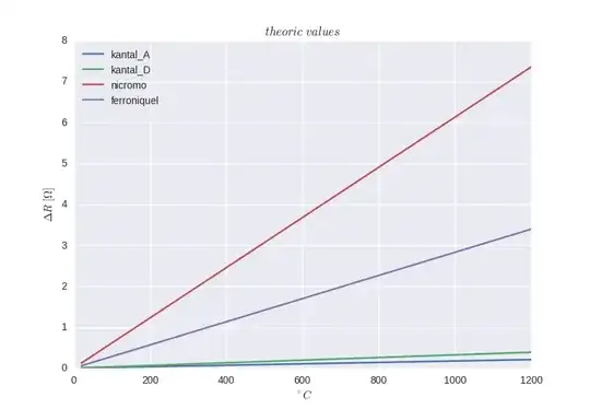

Edit:
I made the measurements but the experimental results are quite off from the theoretical values, at least regarding to temperature. I somehow expect it because of the effect of the thermocouple touching the wire during the measurement is quite evident
Resistance was calculated by measuring current and voltage, and temperature was measured with a K-type thermocouple.
