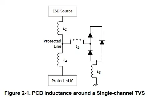

Your assumption holds for this layout. It's a correct layout, because there's no stub between the trace and the TVS pad. An ESD pulse has a very fast raise time and plenty of current. The parasitic inductance in the stubs can present enough impedance and create large voltage gradients. Don't assume that traces are ideal conductors when it comes to ESD pulse.
model which shows parasitic inductances around TVS
[source: ESD protection layout guide (TI app note slva680) ]
L1 should be as small as practical. L4 should be much larger than L1. That means that the TVS should be placed close to the exposed pin. Wide trace has a lower inductance than a narrow one. A wider trace between the connector and the TVS, and a narrow trace between the TVS and the IC makes sense.
