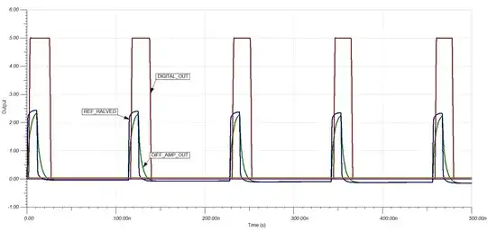

So my results are like this for a difference amplifier followed by a comparator. The pulse here is 10 ns width and 1 ns rise and fall times and repeating at a 150 ns rate.
Enter image description here
Why is the pulse quite expanded? Which capacitor stage has done it I didn't understand.

There is nothing is wrong with your circuit. The wide pulse width is because you're feeding your diff_amp_out to a comparator.
It can only supply you with a pulse of full voltage if the input (in this case) is even slightly above zero volts. I like how your scope shows the tiny delays from stage to stage.
You could adjust the 'trip' level of the comparator, but the output will always be +5 V.
If you just want to amplify diff_amp_out, add another AD8003 op-amp and set your gain to fit your needs. At least you keep your true signal pulse width. Admittedly, working with these nS pulses is tough.

  • my question why the difference amplifier output is quite different, i mean a charge and discharge kind of , rather than a narrow pulse similar to input – kakeh May 02 '16 at 05:20
  • @kakeh. The slew rate at the outputs depends on the load and/or feedback resistor. Normally these frequencies are piped through 75 ohm impedance circuits (look at some rf stuff online). I would keep lowering those values at the IC output to sharpen the waveform rise and fall times until the amps drive limit is reached. Possibly 150 ohm for load and 150 ohm for feedback. –  May 02 '16 at 18:42

I have some doubts about your design.
First, it seems, the whole amplifier AD8003 has no meaning: you first attenuate input signal 2 times by R4 R6 then you amplify it 2 times by U1 R3 R5. Why not to send the input straight to high speed comparator?
The rise / fall times of your optical signal are so short that you can not improve signal quality by AD8003, you only make it worse, as we see from your pictures.
Second, R2 in parallel with R4 R6 has no meaning.
So - the basic question is: what for do you use AD8003 stage?
Master
  • 1,289
  • its a generic circuit, the R2-C2 and R8-C4 are HPF of fc=5Mhz, the R4 - R6 and R3- R5 is a difference amplifier ckt with unity gain, for your info- about difference amplifier http://www.electronics-tutorials.ws/opamp/opamp_5.html, so the stage of AD8003 is a difference amplifier, in reality the Input can be different i.e. from different photo diodes so this stage, question is about exploiting CFA AD8003, you can download TINA from TI and simulate to understand the circuit, thanks for your valuable reply – kakeh May 02 '16 at 08:30
