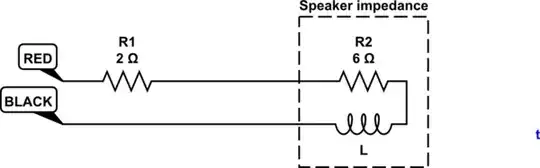

Figure 1. Series connection of resistor.
Since you are increasing resistance in a series circuit the amplifier won't know or care where in the circuit the resistance is. Convention would be to put it in the red or '+' wire.
simulate this circuit
Figure 2. Simplified equivalent circuit.
The problem is that your speaker isn't just a resistor. It is largely an inductive load and since it has mechanical resonance (favourite frequencies to vibrate at) the situation becomes more complex. A good amplifier will have a strong drive to force the speaker to the correct position at any instant and overcome the inductance. Low resistance speaker cables are part of this equation. Adding your 2 Ω series resistance will affect how well the amplifier is able to control the speaker and some loss of fidelity will result.
Try it and see if you notice. The resistors will need to be rated to handle the power. Start with ones rated for at least 1/4 of the nominal amplifier output power rating.

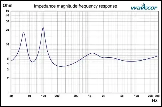

A loudspeaker's impedance depends on frequency. This is the impedance vs frequency plot of a 2-way bass reflex speaker I just randomly googled:
It is a typical plot for a 2-way bass reflex. The bass driver resonance and bass-reflex vent resonance create two peaks at low frequencies, and the crossover between woofer and tweeter is apparent between 1.5k and 3k. This is a 4 ohms speaker. For a 8 ohms speaker the plot would look the same, scaled up by a factor of 2.
Adding a resistor in series will make a voltage divider (see Transistor's answer for schematic), and the voltage on your speaker will depend on its frequency-dependent impedance. This means the frequency response of the speaker will change. The output will be attenuated most where the speaker's impedance is low, but it will have very little attenuation on frequencies corresponding to impedance peaks. Also, damping will change.
So, it will probably sound different, you'll get a bit more bass. This may be pleasant, or maybe not, depending on the speakers, but don't be surprised if you hear a difference.
