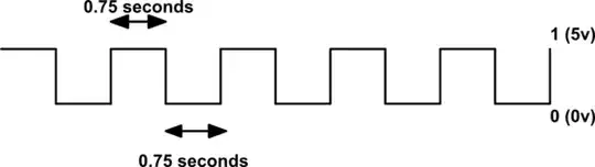

I am trying to make a POV globe and my block diagram is the following: enter image description here
The goal was to make one without using microcontrollers and using basic components available. My main query is that :
What would be the refresh rate of LEDs between different states and how to calculate a particular value so as to sync it with the rotating ring?
