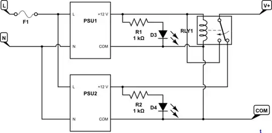

Figure 2. Relay switched PSU. Both PSUs on all the time but one on standby.
simulate this circuit
Figure 3. DPDT relay switches mains on second power supply (preventing it from wasting power when PSU1 is running). A second contact switches the DC side.
Note my schematics show F1 as a common point of failure. The same is probably true of your home supply. You need to take that into account when designing the system.

    Not sure what the problem is, Tim. The LEDs? They're optional (but useful) and will consume about 1 kWh per year - cost about €0.10 - €0.20c depending on location. Apart from that the circuit uses either two diodes or one relay. Can't get any simpler. – Transistor Apr 29 '16 at 21:32
