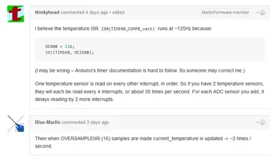

I would like to know at what frequency is the temperature information pulled by the marlin software. I have looked into the code but it insn't obvious to me.
