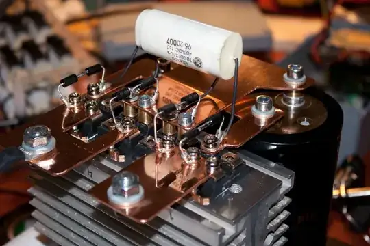

Through-hole components are not designed to be busbar mounted. But I have the need to use "laminated" busbar because of some factors (among others):
  • High current
  • Small parasitic inductance
Power PCBs are also not available for small production, or even not manufactured at the thickness intended. Also they will present some problems to mount too.
Using modules or packages like SOT 227 is not an option now because of the cost, and the added terminals inductance of modules.
I have TO-247 IGBTs and I'm studding ways to mount then to the busbars.
Some of the options:
  • Soldering: As the busbar will conduct much more heat it seems to be difficult to make a good solder without overheating the package (at least with cost effective soldering methods).
  • Pressure: Making some pins in the busbar and pressure mount the pins. But with what method? Also it should be removable to allow for maintenance, even if the connector needs to be cut.
  • Terminals connectors like in this project:
Kaizer DRSSTC I (from http://kaizerpowerelectronics.dk/tesla-coils/kaizer-drsstc-i/)
This project uses the connectors only at some components.
The problems applying that to the TO-247 package transistors is the spacing between leads. The TO-247 has near 5mm pin to pin spacing, so the connector should be small if not to bend the terminal.
(Yes this will add a little parasitic inductance, but probably less than modules).
Any suggestion? Thanks.

Do you have $20? You can solder them for $20. Or for free, if you already have a heat gun.
Why do you think you'll over heat the package? I solder large power transistors, including TO-247 size power transistors and FETs to much more substantial copper than anything in your photo. Like a solid copper heatsink that weighs several pounds. I've yet to have any device be damaged in any measurable way by this. These packages are designed to endure reflow, which usually involves the entire package reaching temperatures of at least 260°C. The bigger TO power packages are designed to withstand several reflow cycles of 260°C for 2 minutes straight, then allowed to cool via natural convection over as long as a 20 minute stretch.
Just use a heatgun/hot air gun like the kind you'd use for heat shrink. 1200W is plenty. Personally, I have one of these. Hardly high end or precision but its effectively a hair dryer with a much lower CFM airflow rate.
Use it to heat the entire copper bus bar to temperature, put a generous amount of solder paste on the back of the transistor, use some pliers and hold it in position against the bus bar. If you heated up the bar enough and it has enough thermal mass, it will bring the transistor up to temperature, melt the paste and flux, and form a very good joint. Keep the transistor immobilized until the solder has completely solidified (which might be a bit below when it stops being a liquid if it is not eutectic - though if you are able, use eutectic solder for this).
That is how you get the highest quality joint, but you can achieve something nearly as good by just slathering on some flux and using wire solder and pliers.
Bringing that much copper up to temperature might seem a little excessive, but that's how its done. You are right, the copper will suck the heat away too fast. Use that to your advantage. Not only can you do the initial joining this way, but it it is perfectly safe and suitable for rework as well.
Entirely due to that great thermal conductivity. That conductivity means that it will spread out heat and become a uniform temperature very quickly, so you can blow air on a somewhat distant section (distant from the semiconductor parts etc.) and this will diffuse the heat and bring everything up to temperature without causing spot overheating. Also, a 1200W heat gun will have no trouble heating those busbars. I can personally attest that it will heat those bus bars up in short order. I've used my 1200W heat gun to heat up 3 pound passive Xeon heatsinks that are solid copper and larger than the aluminum heatsink in your photo, and soldered power components directly to it. They were not damaged from this.

  • @metacollin Thanks. *I would like to reiterate the photo in the post is not from my project, neither my project is a SSTC*. My busbars are near 1,5mm thickness depending on material (copper or aluminum). The data-sheet of the switches says 300C for 10s, anyway your experience counts. The fact is that the busbar have other components, if heating all the copper to solder temperature it will de-solder the other components, and expose then to more accentuated thermal cycles. – Diego C Nascimento Apr 29 '16 at 05:42
  • Just to ensure, I'm not soldering the case (it will be isolated) but the leads. – Diego C Nascimento Apr 29 '16 at 08:03
