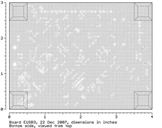

I use Eagle and its auto router often for such things. In the first few routing passes I set the costs just to find a routing solution. In later passes I assume a solution has been found and now it needs to be optimized for least damage to the ground plane. To get that, I set the ground plane layer cost high and the via cost lower. That results in more short "jumpers" in the ground plane layer instead of long traces. Unfortunately Eagle still tends to clump these jumpers together, even with the hugging parameter set to 0. After the final auto route, I manually clean up the ground plane a bit. This is usually not changing the topology, but mostly separating individual jumpers from each other so that there is copper flowing between them.
Here is the bottom layer drawing of such a board:
This shows the bottom layer of our USBProg PIC Programmer. A circuit of that complexity can't be routed on a single layer, but note how there are lots of individual small islands instead of long traces or large clumps of jumpers in the bottom layer. For the most part, the high frequency return currents can still flow without too much deviation from their ideal paths.
