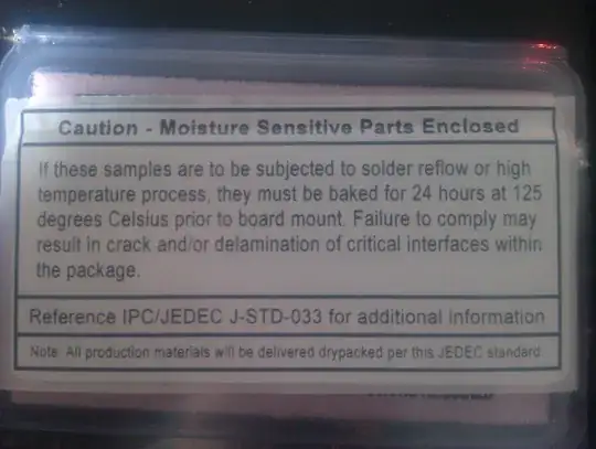

Analog Devices very nicely include the following sticker in their boxes:
That pretty much sums it up.
Caution - Moisture Sensitive Parts Enclosed
If these samples are to be subjected to solder reflow or high temperature processes, they must be baked for 24 hours at 125 degrees Celcius prior to board mount. Failure to comply may result in crack and/or delamination of critical interfaces within the package.
Reference IPC/JEDEC J-STD-033 for additional information
Note: All production materials will be delivered drypacked per this JEDEC standard.
The JEDEC standard can be found here: http://www.surfacemountprocess.com/uploads/5/4/1/9/54196839/j-std-033b01.pdf
As I don't (yet) do anything other than hand soldering, I haven't had to bake anything. I don't fancy my electricity bill after baking something for 24 hours though...
