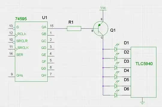

  • I should note that the schematic provided by Majenko is exactly what i have (except for R1 and Q1 so far of course). – Antti Nov 30 '11 at 17:10

If you were running the LEDs in series then yes, you would need a higher voltage. You aren't though - otherwise they'd all be on or all be off. You are running them in parallel.
From what I understand of your description you have the one output of the '595 going into the anode of the all the LEDs of one column. The cathodes of these LEDs then go into separate inputs of the TLC for PWM.
And, as you say, the '595 can supply 35mA of current per output. That is enough for to light one LED reliably.
You will need to supply 6 times that current for 6 LEDs.
The simplest way would be to use a single transistor and resistor per column. For example, the '595 output connects to the base of an PNP transistor through a 1KΩ (for example) resistor. The emitter connects to Vcc, and the collector connects to the LEDs in the same way the output of the '595 used to. When the '595 sets an output low it turns on the transistor which then allows the current to flow from Vcc to the LEDs.
  • I don't know what the TLC5940 does in the way of current limiting - I haven't shown any current limiting resistors that may be required for the LEDs if the TLC5940 doesn't do that for you.
You can't use the TLC with, for example. a ULN2803 as they are both current sinks. You need something which can be a current source, which a transistor can be.

  • Sounds like a reasonable solution. Just a small point on the transistors base resistor - if it needs to sink ~200mA or more then using a lower value than 10k would be a good idea to make sure the transistor gain doesn't limit the current (e.g. assuming a conservative gain of 100, then 3.3V/10k = 0.33mA. 0.33mA * 100 = only 33mA). I would maybe use something like 1k. – Oli Glaser Nov 30 '11 at 15:19
  • True. I'm more used to working with 5v, and NPN low-side switching. I shall edit. – Majenko Nov 30 '11 at 15:22
  • Of course I should have said (3.3V - 0.7V) / 10k = ~0.26mA for the base current. – Oli Glaser Nov 30 '11 at 15:34
  • Close enough :P – Majenko Nov 30 '11 at 15:37
  • This worked great! Really appreciate the explanation too, i now understand much better what was happening – Antti Nov 30 '11 at 21:41
You need to use a pnp transistor as the high-side switch. Use the 595 to drive the transistor (0 is on, 1 is off) through a resistor to limit the base current. The discrete transistor will be able to source far more current than the shift register.

Unlike what others have said, you don't need a PNP high side switch. That's one option, but a NPN emitter follower is even simpler. Connect the collector to the 5V supply, the base directly to the 0-5V column drive logic output, and the emitter becomes a voltage source for that column. The digital logic output only has to supply the column current divided by the transistor gain. For example, if the column current is 300 mA and the transistor gain is 80, then the digital output only needs to source 4 mA.
This scheme provides up to about 4.3V, which leaves about 1V for the low side switch and current limiting resistor. In this case I would use NPNs as low side switches.
