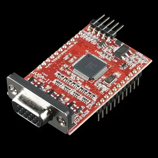

Sparkfun say $US55/1 for
  • Description: The µVGA-II(SGC) is a compact & cost effective drop in embedded graphics engine that will deliver stand-alone functionality to your project. The simple to use embedded commands not only control background color but can produce text in a variety of sizes as well as draw shapes in 256 colors while freeing up the host processor from processor hungry screen control functions. This means a simple micro-controller with a standard serial interface can drive the module with ease.
Product page
Datasheet
  • Features:
    • Intelligent and fully integrated VGA/SVGA Display Graphics Controller Tiny 28 pin module, powered by the 4D-Labs PICASO-SGC chip - a powerful DSP/Controller based multi purpose graphics engine 4.0V to 5.5V range operation
    • Supports RGB 65K true to life colours in QVGA, VGA, WVGA and Custom resolutions.
    • The µVGA-II(SGC) supports multiple resolutions within the same module. Resolutions are selectable during run time under host control. Resizeable viewing window allows partial/full screen control. 15 pin D-type standard VGA connector to interface to any external VGA monitor.
    • On-board micro-SD memory card adaptor for multimedia storage and data logging purposes. HC memory card support is also available for cards larger than 4Gb. Easy 5 pin interface to any host device:
      • VCC, TX, RX, GND, RESET. commands.
    • Asynchronous hardware serial port, TTL interface, with 300 baud to 256K baud. Powerful, easy to use and understand built in graphics functions allow drawing of lines, rectangles, circles, ellipses, text, images, icons, user defined bitmaps and much more
    • Future upgrades and enhancements are easily achieved by uploading PmmC (Personality module micro Code) files. PmmC files allow the PICASO chip to be uploaded with the latest micro-Code firmware. System designers can incorporate the µVGA-II(SGC) module directly into their application, saving space and cost. Reference designs enable the user to create a platform to incorporate the µVGA-II(SGC) easily

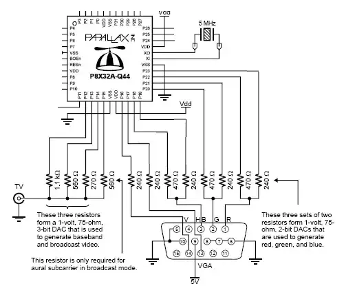

The Parallax Propeller CPU can generate either VGA or NTSC/PAL composite video directly without any additional components except some external resistors.
The following circuit (adapted from one of their demo boards) shows all of the circuitry required for either VGA or composite video:
The chip comes in either a 40-pin DIP or 44-pin QFN/QFP and costs $8 in single quantities.

    Thats easy peasy! and cheap :) – Piotr Kula Dec 02 '11 at 16:03
  • Heh, true. There's enough free port pins to interface it directly to the 68k with an 8-bit bus, too. I've needed a good excuse to get into these Propeller chips for a LOOOONG time now. =P – Tristan Dec 03 '11 at 02:26
