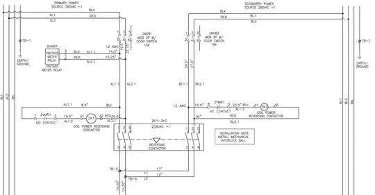

We have a an industrial control system that utilizes a 480VAC 3 phase 10 Amp service. For redundancy reasons, we wanted to add an automatic transfer switch to the system to switch between two redundant power sources (each are 480VAC 3 phase). Automatic Transfer Switches (ATS) are expensive and usually pretty large. We would like to use the following scenario instead of the ATS:
  1. Use a reversing mechanically/electrically interlocked contactor to switch between the two power sources.
  2. Use two voltage sensing/monitoring relays (3 phase) to sense if the phases and power is good on either power source. If the primary power source fails, the voltage sensing relay would detect this and energize the coil on the contactor to switch to the redundant power source.
  3. Add circuit protection (most likely breakers) before and after the reversing contactor.
We do this type of setup on a 208VAC single phase system and it works great. Here is a diagram of that setup:
208VAC REDUNDANT POWER
Other concerns I have is arcflash requirements, phase sync issues, and if UL would be ok with it.
The 480VAC in our system supplies power to a VFD and a 480VAC to 120VAC transfomer. These would be the piece directly affected from switching from one power source to the other.
Any insights would be greatly appreciated.
Greg
If you are building this for sale probably needs to have the label of an nationally recognized independent testing laboratory such as UL. If you don't have a relationship with such an organization that allows you to label control units that you build, you can't meet that requirement.
If you can get it approved, you still have the question as to whether or not it will work. Directly connected motors will have an unacceptable level of stress from an unsynchronized transfer. A VFD should be able to withstand the transfer, but will likely shut down. Many VFDs have features that may be able to prevent a shutdown, have only a speed variation, or shut down and immediately restart automatically.
  • Great thanks for the response. The panel is and will be UL labeled to include this. We are building the prototype to see how it goes. I will call the VFD manufacturer to see if they have anything to say about switch power sources. – Greg Apr 18 '16 at 22:28
