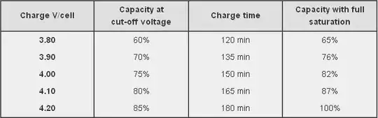

Added last. This table from the battery university reference below provides excellent comment on LiIon charging times.
The manufacturer specified maximum charge current is C/1 (= 1A per Ah of capacity) but some specify C/2, a few 2C, and some specialist cells may allow much higher charge rates.

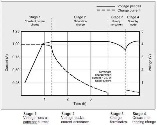

  • The Li‑ion charger is a voltage-limiting device that is similar to the lead acid system. The difference lies in a higher voltage per cell, tighter voltage tolerance and the absence of trickle or float charge at full charge. While lead acid offers some flexibility in terms of voltage cut‑off, manufacturers of Li‑ion cells are very strict on the correct setting because Li-ion cannot accept overcharge.
  • The so-called miracle charger that promises to prolong battery life and methods that pump extra capacity into the cell do not exist here. Li-ion is a “clean” system and only takes what it can absorb. Anything extra causes stress. Most cells charge to 4.20V/cell with a tolerance of +/–50mV/cell. Higher voltages could increase the capacity, but the resulting cell oxidation would reduce service life. More important is the safety concern if charging beyond 4.20V/cell. Figure 1 shows the voltage and current signature as lithium-ion passes through the stages for constant current and topping charge

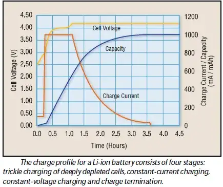

The charge time is about three to five hours, depending on the charger used.
Generally, cell phone batteries can be charged at 1C and laptop-types at 0.8C,
where C is the current that would discharge the battery in one hour.
