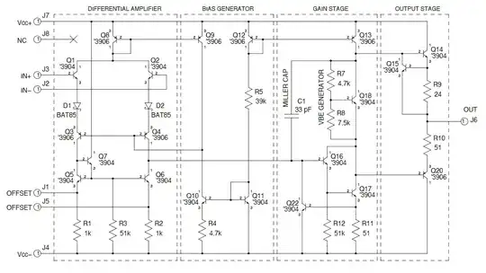

Here is a $35 kit you can make, which ends up being the equivalent of a 741 op-amp using discrete 13 2N3904 and 7 2N3906 transistors. It has eight binding posts representing the eight pins of the device.
Here is a link to the datasheet, which includes the schematic for the kit (shown below) and a BOM.

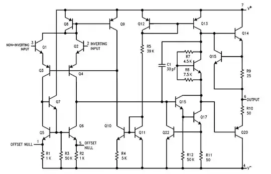

Compare that to a "real" 741 out of the TI datasheet:
They are virtually the same, even down to the resistor values.
There is also an 11 page "Principles of Operation" which goes into quite a bit of detail on how it works. And finally, they have a Wiki.

    Also note that it will not be as good as a 741 in several areas, especially offset voltage and drift. The input transistors Q1 and Q2 are neither matched nor thermally coupled, both of which are important to modern (IC) op amps. – WhatRoughBeast Apr 11 '16 at 03:55
    @WhatRoughBeast That's why I posted a link to the datasheet for the kit, so he can compare the parameters with the TI datasheet. Still I thought it's a pretty cool way to learn about the guts of an op-amp, especially following through the circuit as explained the the Principles of Operation. It handles topics like Offset voltage, including use of the Offset Null pins 1 and 5. – tcrosley Apr 11 '16 at 03:59
