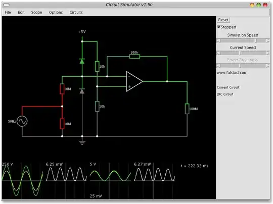

I am trying to create a circuit which will allow me to scale and offset a voltage (be it AC or DC) to within the range of the Arduino ADC.
The voltage could be anything between + and - 250V, but I also need to have good sensitivity over lower voltage ranges too.
To this end I am looking at a circuit whereby you can vary the voltage range that it expects the input to be and amplify/attenuate it accordingly. How I will be making the decision and setting the different gains is for another topic for now. I am only interested in the scaling and offsetting at the moment.
So far I have come up with this circuit:
Which appears to do just what I want for the +/- 250V range. I don't know how "safe" this circuit is, and if I am endangering any of the components with the 250V or not. The graphs at the bottom are (left to right) the input voltage, the power consumption of the bottom 10M resistor, the voltage across the 100M resistor (which is simulating the Arduino ADC input) and the power consumption of the upper 10M resistor.
Now, if I drop the input voltage to just +/- 2.5V and tweak the op-amp feedback resistor accordingly, for some reason the offset voltage the op-amp is adding jumps right up. I don't know for sure if this is the fault of the simulator I am using, or if it is really what will happen, as I haven't yet breadboarded this circuit (I guess that's the next stage).
This is the output from the 2.5V version:
You can see how the offset has jumped up and the output is clipping massively.
If I drop the lower 10K resistor to the virtual ground offset voltage divider to just 3.3K it compensates, but that's not nice - I would like to just vary the one resistor.
The op-amp is (will be) a 5V single supply rail-to-rail I/O one.
The two diodes are to protect the input of the op-amp against over voltage - I don't know if this circuit strictly needs them, but I guess it doesn't hurt to have them there.
Also, I don't know if the resistor values are quite what I want - I chose them to keep the power consumption right down and the impedance right up. I don't want them to impact the frequency response of the circuit more than I can help - the input waveform could be anything from DC up to around 500KHz or so, and I need that reproducing at the ADC end as faithfully as I can. (I know the Arduino can only really sample at lower speeds than that, but the Arduino is just for experimenting - the final system will use a dsPIC with 1.1Msps ADC).
So, what can I do to A) get a more stable offset, B) allow the varying of the input sensitivity without nuking either the op-amp or the ADC, and C) make the circuit safe to connect to, for example, a European mains voltage?

Several comments:
  1. Add component designators to your schematic. It is difficult to talk about the circuit otherwise.
  2. You appear to be a little confused about resistor dividers. You have two resistor on the input, but only one is doing anything. The resistor to ground is just a load on the input but otherwise has no bearing on your circuit. It sortof looks like the two input resistors (component designators would definitely help) are meant to be a divider that didn't get hooked up right.
  3. Yes, you can use opamps for gains below 1, but you might as well use resistor dividers instead. Also keep in mind that at best opamps are specified as stable for unity gain magnitude, but not below. You would have to add your own compensation for that.
  4. Three resistors, one from the input voltage, one to ground, and one to the supply can be adjusted such that the input voltage range maps reasonably well to the 0-5V A/D range without any active parts. You can then use the opamp as a voltage buffer because the output of the resistor divider may not have low enough impedance.
  5. Instead of changing gains, I would just have a few different gain setups driving different A/D pins. As long as the voltages are properly clipped, they won't hurt being out of range. The full 220V signal may be out of range for the high sensitivity A/D input, so you ignore that and only use the low sensitivity reading. When the signal level is low, the high sensitivity input won't be clipped, so you can use that. Nothing needs to change except in the firmware, which decides which input to use for the particular magnitude of input signal.
  6. 500 kHz is a lot for the high value resistors you show. Those should work at 50 Hz, but at 1000 times higher frequency the parasitic capacitance will be significant compared to those resistances.

  • 1: I would love to but the sim software doesn't let you. 2: what should I do here then to get it right? 4: Any chance of a schematic for this? 5: That's a great idea - it would mean a bigger PIC though in the final design, which isn't a problem. 6: Can I use lower resistors and keep the current down somehow so I don't have to use one the size of an apartment block when using 220V? – Majenko Nov 26 '11 at 00:43
  • That's some fantastic info there Olin, thanks. I'm off to tinker with resistor dividers now. – Majenko Nov 26 '11 at 16:49
The offset voltage is increasing as you have increased the gain and you have the non inverting input set above "mid point".
With the top circuit there is actually attenuation, so the opamp doesn't have to drive it's output very hard to keep the inverting input at 2.5V.
When you increase Rf to 10Meg, the output has to drive it's output to the necessary voltage to match the input current and keep the inverting input at 2.5V.
For example, with 0V on the input, then the output must swing to 5V to keep the inverting input at 2.5V. Basically if you have Rin the same as Rf, and you know the input voltage (0V) the midpoint voltage at -IN (2.5V) then it's easy to work out what the top of the voltage divider (opamp OUT) should be (5V)
If your signal is swinging around a different point (0v) than the opamp midpoint (2.5V) then when you change the gain you will also alter the effect the DC offset (e.g. 2.5V) has.
