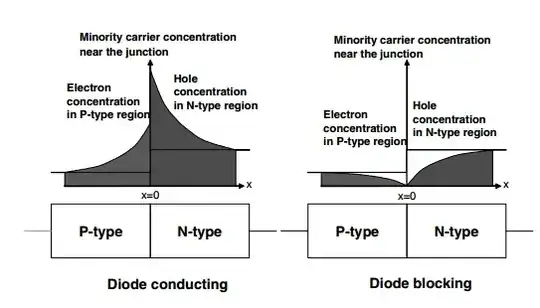

Regarding the diode changing from forward mode to reverse mode, there's an article from Fairchild, perhaps you've seen it already. An interesting picture is this one:
The minority carriers changing position takes some time. The time it takes to change from the conducting stage to the blocking stage is the reverse recovery time.
