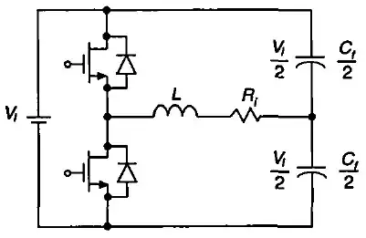

I’ve designed a Class D series resonant inverter, for use in an induction cooking application, which is displaying a strange behavior in its measured current vs frequency curve. The topology, reproduced below, is basically a series RLC circuit fed by a square wave voltage.
Class D series resonant inverter topology
