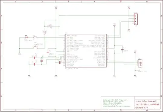

Take a look at this example schematic:
Example Schematic
The chip in question is the PIC18F4550 and as you can see power is provided on both sides (with a 100nF cap to smooth noise I guess). Is this strictly required or could you put power into one side and just ignore the other? I know that I have just put power in one side and everything still seems to work fine but I feel uneasy with doing that. I feel that they would not waste pins that could be doing something useful by having an extra pair of power in/out pins.
For what purpose does this PIC MCU (and others like it) have multiple power pins?

Each Vdd and Vss pin (and AVdd and AVss, if present) must be connected, and each pair should be decoupled. Multiple supply pins with their own decoupling ensure that different parts of the chip receive a clean low-impedance supply, which wouldn't be the case if the supply was distributed inside the chip itself.
For decoupling to be effective, the connections to the pins should be short with wide tracks to minimise inductance. The supply track should go to the capacitor and then to the pin, just putting the capacitor on stubs with the supply and ground going to the pins first isn't a good idea.

As stated in the datasheet, all power and ground pins must be connected. This includes analog power and ground too (AVdd, AVss). Each power pin should have its own bypass capacitor as close as possible to it.
Multiple Vdd and Vss pins are probably internally connected to a point. However, due to constraints of the die, each of these feeds is separately required. The PIC may appear to run with only one pair connected, but some voltages inside the chip are then probably not as intended and various subtle things might go wrong.

While you can run a PIC off just the one pair of power/ground it isn't advised.
  • One power pin can only safely provide a certain amount of current. Having 2 doubles that current capacity.
  • The ground pins are often also heat-sinks, so not connecting them could cause too much heat to build up in part of the chip.
  • Multiple decoupling capacitors with separate feeds into the chip will improve the overall current draw and signal cleanliness of the PIC.
So yes, for simple experimentation and prototyping you can just use the one pair if you want, but for anything in production use them all.

You must connect them all.
Not doing so is a recipe for interesting times. Often the core will come up, and everything may seem to work, but then you start getting odd failure modes - on-chip peripherals not working, I/Os not driving to full voltage, etc

Processors that have multiple power supply pins do so to lower parasitic resistance and inductance from the power supply -- low parasitic inductance is very important at high frequencies for a processor that has fast supply current transients.
If you do not connect all power supply pins, with appropriate bypassing (i.e. capacitors connected with short traces), the power supply voltage as seen on the chip will experience voltage transients that may be outside the operating spec for the part.
