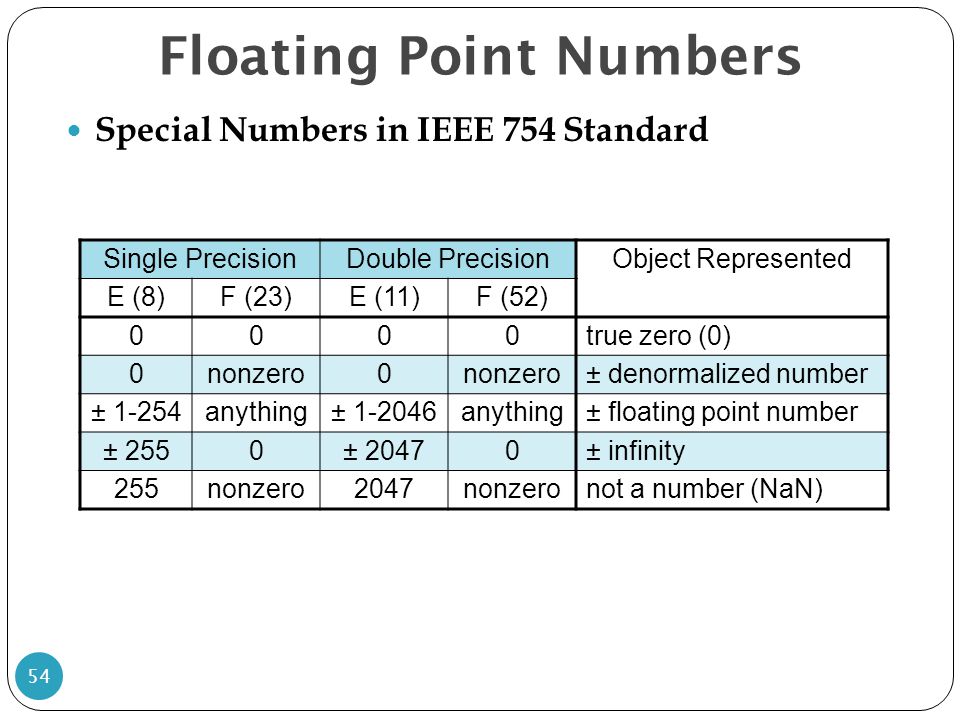

Regarding the normalized and denormalized representations of binary floating-point numbers (as described in the book by Patterson), I want to know how a denormalized number is really shown.
See the table below which is saying that \$e=0\$, \$f\neq0\$ is a denormalized number.
Floating Point Numbers - Special Numbers in IEEE 754 Standard
(Image source)
Consider the number \$1.10\cdot2^0\$. Isn't that normal?

The number 1.10 20 is a normal number. The table that you referred to shows exponent values as represented in IEEE754 format, where it actually stores a biased exponent. For single precision float types, the exponent is added a bias of +127 to actual exponent value. This transforms a real range of [-126, +127] into [1, 255]. Notice, that the range used to represent exponent doesn't have '0' in it. Thus, exponent value of '0' is special and considered to represent either actual '0' value or a denormal number.
Coming back to your example, the actual exponent '0' would be represented as '127' in IEEE754 format and hence it is not to be confused with a value that may result in represented value of '0' (real exponent -127 or lesser). For more information and a lucid explanation, you may also refer to this article

It is a common source of confusion indeed.
The value of E is an encoding. It's not always just an offset exponent value(!).
  • When E has all binary ones (E=11..11b), there is no exponent value at all, since we are not encoding a number (!).
  • When E is all binary zeroes (E=00..00b), it encodes the same exponent as E=00..01. In single precision, E=0 and E=1 encode exponent -126. In double precision, they encodes exponent −1022.
Additionally, when E=0, the left-most implicit bit of the mantissa is taken to be 0, not 1 as it otherwise would be.
Concretely:
E single precision
exponent
double precision
exponent
implicit
mantissa MSB
0 -126 -1022 0
1 -126 -1022 1
2 -125 -1021 1
Emax-2 126 1022 1
Emax-1 127 1023 1
Emax-0 NaN NaN NaN
A denormal number has a smaller magnitude than \$1\cdot 2^{-126}\$ for single precision, and \$1\cdot 2^{-1022}\$ for double precision. Such numbers do not have an implicit binary 1 in the MSB of the mantissa.
Observe that the implicit MSB of mantissa has the same weight as the exponent would indicate. I.e. a number \$1\cdot2^0\$ has an implicit one with weight \$2^0\$, and the most significant explicit mantissa bit's weight is \$2^-1\$.
When we'd like to represent a denormal number, say, \$0.5\cdot 2^{-126}\$ in single precision, we must encode exponent -126 and an implicit MSB zero. Thus, the encoding is S=0,E=0,M=100..00b or 0x00400000.
