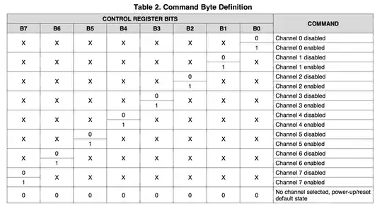

Note: This is not a 'normal*' mux.. rather it is a 'branch selector' that can have many or no branches connected. Your control byte, defined as enter image description here
is used to select the MOSFET switches individually
and you can turn on or off any branch arbitrarily.
*A normal mux would code to 001 -> 00000001, 010 -> 00000010, 011 -> 00000100...

  • Also, do you realize that this mux can tie all of the busses together simultaneously? It's not a 'normal' mux, but more of a bus with on-off switches. – Daniel Apr 04 '16 at 16:16
  • Can you elaborate on your last comment? I didn't really understand the difference between this mux and the normal one. – am3 Apr 04 '16 at 16:17
  • @Agm I addressed it with an edit by adding some pictures from the datasheet. Where I said 'normal mux' I probably meant 'demux' ha – Daniel Apr 04 '16 at 16:27
