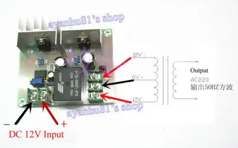

This circuit comes with an LTSpice model. LTSpice treats all transformers and inductors similarly, and the model does not mention things like "magnetic saturation, eddy current, flux density". The simulation works very well (it's what LTSpice was written for) so there seems to be no modelled difference to using a standard mains step down transformer. Indeed, this item available on a well known auction site clearly shows a 12-0-12 mains transformer-
SMPS driver board with mains transformer
There is a 1:10 transformer in my original above example. That's very similar to a standard 230v – 24v transformer backwards. Why hand wind or look for the elusive Wurth?

  • You're _not_ going to be able to use a normal 230V transformer in this application, they're designed for completely different use cases and have very different properties than the transformer you need in the converter shown. – pipe Mar 30 '16 at 22:16
  • @pipe -why please? – Paul Uszak Mar 30 '16 at 22:20
  • @PaulUszak I'm not experienced enough to answer that question, but it has to do with magic words like _magnetic saturation_, _eddy current_, _flux density_, all of which I know little about. Another stack exchange question would be better suited for this. – pipe Mar 30 '16 at 22:37
    A mains (50-60Hz) transformer is typically wound on a laminated silicon steel core. These work great for that application, but are prone to *eddy losses* which become oppressive when the frequency rises much higher than say a few hundred Hz. The steel is a conductor, and a current is induced in a conductor subjected to a varying magnetic field. That current circulates in the steel (thickness-wise) and generates heat. The reason the steel is laminated (and each layer insulated) is to keep those eddy current loops small (limited to one layer thickness). Switching cores are typically ferrite. – scanny Mar 31 '16 at 02:42
Flyback transformers require a very small air (or other dielectric) gap within the magnetic core structure. This helps prevent core saturation but lowers inductance. Most transformers that you're familiar with aren't the flyback type so they would saturate early and fail to function well as a flyback so you can't just swap in a random transformer from some old, no longer used electronics usually. Between difficulty finding the exact right type of transformer for your application, cost, availability, and ease of finding magnet wire, it's not terribly surprising that many choose to make their own for one-offs.
Lastly, although using old transformers from other electronics may work, it likely won't work well because there's engineering tradeoffs that are made that probably aren't anywhere near ideal for your application. In total, not only are you looking for the correct ratio of turns, you want wire thickness that will keep your resistive losses to a minimum, inductance that's suited to your circuit, and in this case, an airgap in the magnetic core.

  • @PaulUszak Efficiency will be greatly compromised, your output voltage likely won't be as high, you may immediately cause catastrophic failure because you're creating a voltage higher than the insulation breakdown voltage was spec'd to, or with all the extra heat wasted, you may melt the insulation causing premature failure. As an experiment you can try it, but don't expect it to last unless you know all of the design parameters of the old transformer actually match your application. – horta Apr 03 '16 at 14:40
  • Even more so with cheap mains transformers that often do not only not have a gap, but have their laminations welded with reckless abandon (giving better mechanical stability but disgusting idle losses).... – rackandboneman Sep 26 '17 at 10:33
