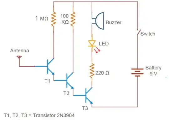

No you can't, there's not enough energy you can harvest that way. Your stud finder is almost certainly a battery-powered non-contact AC voltage detector, which looks something like this from electrical standpoint:
Also check answers to this question which explain how much energy you can actually collect (spoiler: fetmowatts).

I came up with the idea after using a stud finder which has a little red LED that illuminates in the presence of live wires with a few cm range.
The electric field generated close to a pair of live-neutral wires is sufficient to be detected and amplified in order to light an LED. At anything more than a few inches distant, the e-field strength is quite low and, if trying to extract power, the localized e-field will collapse.
Regarding the magnetic field generated by load currents flowing in the wires it's a similar story - current travels down live wire in one direction and returns up the neutral wire in the opposite direction i.e. ampere-turn cancellation. At a few inches (and beyond) there is very little usable power.
Think about the power losses in metal conduits if this were not the case.
