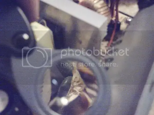

I was tearing open an old ATX power supply from one of my old computers today, because it was making a funny high-pitched wining noise.
I noted that several of the components within were starting fuse together into a sort of electronics mush.
My thought is that it's probably no-longer safe to use this power supply, so I swapped it out in the old computer I was using.
Here are a few photo of the component mush:
Three little components in their mushie state.

    It's not clear what that picture is showing. It looks just some stuff caught between components, but it's hard to tell. It that a dead moth or something? – Olin Lathrop Nov 19 '11 at 23:02
  • @OlinLathrop A dead moth? heheh No it was really hard to get a picture...it's two blue things that stand up in the air, and a small circular orangey-brown thing...I dunno what they are... – leeand00 Nov 19 '11 at 23:23
    Could be leaked electrolyte from a bad capacitor? Though if it has volume, I'd consider some kind of bonding goup or even a contaminate from an external source more likely. – Chris Stratton Nov 19 '11 at 23:50

  • We really need a better picture to be able to answer this. – marcelm Nov 20 '16 at 22:32
Can't make out what the picture is supposed to be of, but the mush you refer to is likely some thermal compound or adhesive.
It's probably one of the inductors or transformers on the board, which can vibrate slightly when passing a switching current. This is called magnetostriction. Capacitors can also buzz but it is more likely to be the magnetics.
It is not an indicator that the power supply is faulty. You can dampen it by making sure the magnetic components are solidly fixed to the PCB (e.g. with the adhesive mentioned above)
