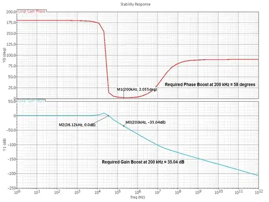

Desired crossover frequency is 200kHz(1/5th of fs). I've marked the required gain and phase boost that compensator has to provide at 200kHz. So I have designed the type-3 error amplifier with above points in mind:

$$ R3 = \frac{1}{2 \pi C3 fp2} = 9.9k \Omega $$ For a gain of 35.04 dB at crossover frequency: Evaluating magnitude response at 200 kHz, with R1 = 6M
$$ R2 = 19.47 M \Omega $$
$$ C2 = \frac{1}{2 \pi R2 fp2} = 0.0005 pF $$ $$ C1 = \frac{1}{2 \pi R2 fz2} = 0.327 pF $$ Here is the schematic and response of the compensator with above values:

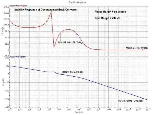

Now when I run the AC analysis for the entire loop, the results appear to be more than fine:
The shape of curves looks fine but the stability margins don't seem right. A gain margin of 292 dB? Is there anything wrong in my results?

Your approach looks sound from a theoretical perspective. From a practical perspective, the exact phase margin point isn't a concern so long as you have -10dB (or less) gain. Your gain line looks fine to me.
Your simulated results are going to be somewhat different from reality even if your components match the values you chose, as parasitics and other delays not considered by your model will affect the overall loop response. That being said, this sort of theoretical computation is generally the first step in designing a stable compensation network. The subsequent steps, of course, would be:
