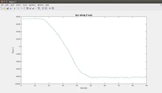

Test 1: 180° rotation along the y axis in 16G resolution. The acceleration along the Z axis is shown below:

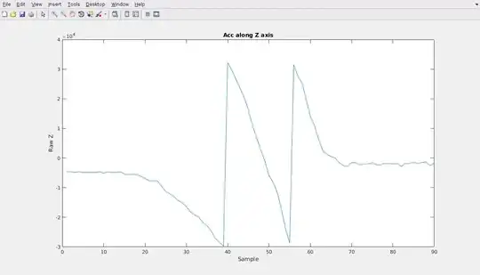

Using a 16g configuration, the resolution is too low. I changed it to 2g in order to get a more accurate value of gravity and performed the same test.
Test 2: 180° rotation along the y axis in 2G resolution. The acceleration along the Z axis is shown below:
As you can see, the is a roll over effect probably caused by the number of bits used in the register to save the value. With 16g mode the module uses a 13 bit register, with 2/4/8g mode it uses a 10bit register.
Which approach do you suggest to reconstruct the acceleration value?
In this question @davidcary mentioned the roll over effect.

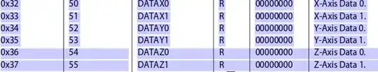

accel_zout = adx.read_word_2c(0x36)
Here is a screenshot of the registers containing the Zaxis values

The reconstruction you are looking for is called unwrapping. I have implemented this in C++ with good results last year when measuring the total revolution of a car wheel. In matlab: link
Q = unwrap(P,tol)
The "roll over" observed (actually, a wrapping) is not caused by register overflow, but by the signal change of measured gravity acceleration. The tolerance tol should be half the peak-to-peak amplitude observed.
In C, it would be something like this (haven't tested this, but the idea is here):
