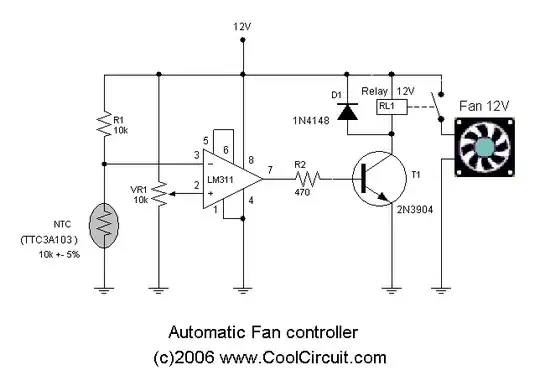

This circuit looks like it would do exactly what you want. BUT it may not, as we don't yet know exactly what you want. This shows a 12V fan but 24V would work equally well. This use a relay to turn the fan on and off but you could connect it in the transistor collector if the transistor was suitable. As you have not told us the fan power or current rating we can't be sure about the transistor. That circuit is from here but they stole it from somewhere else to get people to look at heir ads so ignore them.
Here is a direct fan drive circuit that is otherwise similar.
IF you use the 24V for op amp supply and FET you'd need a zener on the FET gate to limit gate drive. A say 12V zener so Vgate - ground ~=12 V would be OK. Change R2 to say 10k. P1, R1, P2 could all be larger with increased voltage. They are non critical as long as you understand how they work and can adjust as required. Circuit and OK writeup here. Note that P2 operation is important. It provides "hysteresis" which controls how much diffetrence there is between fan stop and fan start temperatures.

  • Hey Russel, I've been checking out your first comparator circuit that you posted a few days ago, and I was just confused about a few things. -Which type of relay should I use (it has to be through-hole) -VR1~is this a potentiometer? If so, I thought that the fan speed was determined upon R1 rather than VR1 – maraldz Nov 19 '11 at 22:54
    Relay must: 1. work with the supply voltage used 2. be able to be driven with transistor used. 3. be able to operate fan load OK || You should try VERY hard to understand how the circuit works.| VR1 is a pot. that set the voltage on comparator pin2 = in_+. R1 and the thermistor form a divider which sets the voltage on comparator pin3 = in_-. The fan is ON when V from VR1 is greater than V from R1 and thermistor. SO any of VR1, thermistor, R1 are part of making fan start or stop. BUT Fan speed is FULL ON or OFF. An on/off relay will not control fan SPEED. Only circuit 3 controls fan speed. – Russell McMahon Nov 20 '11 at 00:11

There would be various ways of doing this, depending how accurate you want it to be.
You could use a simple comparator that turns on/off according to a set temperature and add a bit of hysteresis to prevent it cycling too quickly.

  • @maraldz - The "best" way is the one that meets your specifications fully whilst not being unnecessarily over-complicated. As mentioned above the comparator (see top schematic posted by Russell) is probably the simplest way. If you let us know how accurately you want it to maintain the setpoint temp (i.e. do you mind if it's swinging around the set point +/- 5 degrees or?) then the best way out of the few suggested can be picked. If you do want to try PI or PID in a micro I can advise and send you some code. Or as Russell mentions you can do PI with an analog circuit quite easily. – Oli Glaser Nov 18 '11 at 17:24
  • My specifications are open for changes. Russel's proportional controller makes the most sense, however the circuit might not be complex enough for my teacher--on the other hand, it also looks good that I can simplify a circuit instead of making it more complicated. I am liking the 1st comparater circuit too, the thing is that I have to order/buy my parts so I have to commit to one. Another question I have; What should I use for an external heat source? Thank you for your time guys :) – maraldz Nov 19 '11 at 20:50
    @maraldz - I don't know what your teacher is expecting, but if you are wanting to keep it quite simple but with reasonable performance then I think the 3rd circuit in Russells answer is the one to go for, or something like it. This can be made to perform better than the on/off comparator version, but it will require a little more though about transistor power dissipation. If you can select your heat source then why not use something small (e.g. a small bulb, or maybe even a couple of resistors) and then you can downsize your fan too, making power control easier. – Oli Glaser Nov 20 '11 at 08:02
