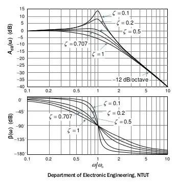

And it could produce several spectral responses as shown below: -

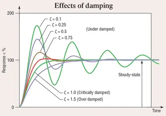

What you don't want is a high resonance peak (low values of zeta, \$\zeta\$) because you might generate an output voltage that could exceed the absolute limits of what you are feeding. Consider the scenario where your target load is a 5 V logic circuit that is easily damaged with 6 V and, if the supply to the input of the filter came-up (activated) quickly, it could cause ringing on the output and the first peak could be disastrous: -
