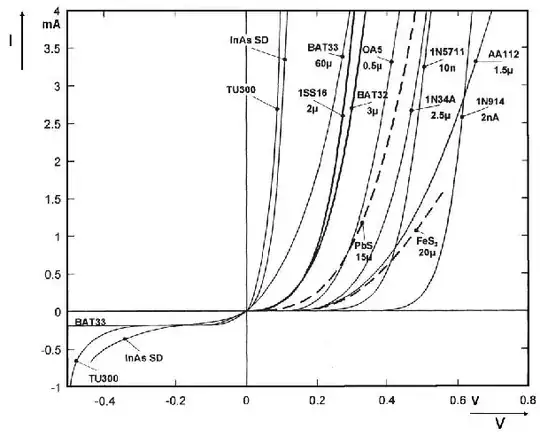

It's never this black or white: -
All diodes have a VI relationship that is non-linear in their forward conduction area and will never have a boundary where they conduct/non-conduct. Look at the graph above - with 100 uA flowing, the forward volt drop of the 1N34A diode is about 0.1 volts. Look at this graph: -
For the 1N34A (green) the volt drop is about 50 mV with 30 uA flowing.

As you can see from this diagram (from here,) enter image description here
The 1N34A will conduct 0.5mA at about 0.3V.
0.3V divided by 20kOhm is only 0,015mA, so that's plenty of currrent to drive a crystal earphone.
Due to the I/V curve of the diode, the forward voltage of the 1N34A in a crystal radio is lower than you would expect from the Vf entry in the datasheet.
