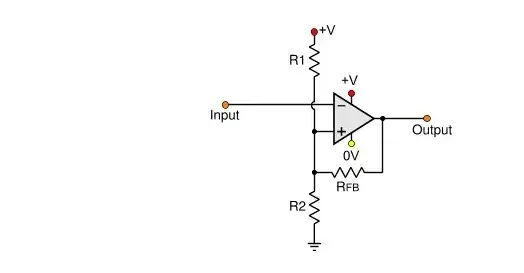

Pic1
As input bias current is almost zero, op-amp draws almost 0 current. So by KCL law, from the above circuit, we get:
$$\frac{0-V_2}{R_1} = \frac{V_1-0}{R_2}$$
As \$R_1\$ becomes equal to \$R_2\$, we get \$V_2 = -V_1\$. Remember that these \$V_1\$ and \$V_2\$ are inputs to differential amplifier. So the difference of the input signal increases and their average becomes zero as \$R_1\$ becomes equal to \$R_2\$. And this happens with help of the op-amp U1C (remember this op-amp helps by drawing zero current and it making V=0).

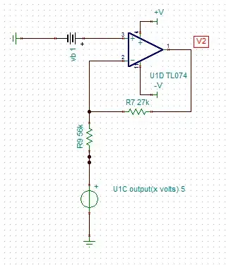

Let us analyze the upper left op-amp U1D. Let the output of op-amp U1C be \$x\$ volts. So the op-amp U1C has been modeled as separate voltage source as shown below:
pic2
The output of the above op-amp U1D is:
$$V_2 = {\frac{1+R_7}{R_9}}\cdot(V_b-x)$$
This actually our \$V_2\$. Similarly, the output of U1B is:
$$V_1 = {\frac{1+R_8}{R_{10}}}\cdot(V_a-x)$$
This actually our \$V_1\$.
