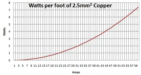

From the comments and answer from Olin and Jason, I've created the following graph showing Watts per foot of \$2.5mm^2\$ copper wire:
Watts per foot
But how do I translate this into the the actual temperature rise. I understand that the missing variable is the rate of cooling, but I just need to get an idea of what the maximum safe current is that can be passed through copper cable of a given thickness.
Assuming a constant current, and that there is no cooling at all, how do I calculate the degrees of temperature rise per hour per Watt for the foot length of copper cable in question?

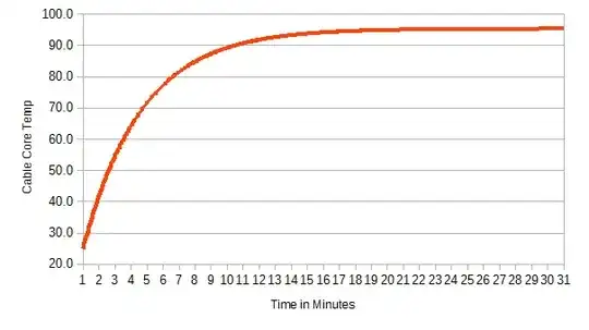

Time required to reach steady state temperature
How long it will take to reach this temperature can be estimated by considering the short-circuit current rating of the cable. Looking it up in the tables, 2.5mm^2 @ 1second short = 358 Amps.
The heating transition of the cable follows approximately the following equation:
$$\Theta_{op}=\Theta_{amb}+\Delta\Theta_{ss-amb}\left(1-e^{\frac{-t}{\tau}}\right)$$
$$\tau\text{(min)}=\frac{1}{60}\cdot\left|\frac{I_{1s-short}}{I_{max}}\right|^2=\frac{1}{60}\cdot\left|\frac{358}{24}\right|^2\approx 3.7\text{min}$$
\tau defines the time it requires to reach 63% of the final temperature. Normally we estimate that at 5*\tau we are at around 99% of the final temperature. 5*3.7 min = 18.5 minutes.
$$\tau \text{ is valid for reaching any calculated steady state conditions}$$
$$\text{Time to reach any steady state temperature} \approx 5\cdot\tau \approx 18.5\text{min}$$
$$\Delta\Theta_{ss-amb} = \Theta_{steady state}-\Theta_{amb}$$
If we plot this it looks as follows: enter image description here
ballpark/estimated demonstration
Our calculated \tau was with values: Ambient temperature 45ºC, operating temperature = 90ºC. \Delta T = 45ºC. I_max = 24 Amps
Power dissipation follows a square rule, P=I^2*R , we could extrapolate that to say that rate of temperature rise follows a similar square rule. $$K_{\tau}\approx\left(\frac{I_{ref}}{I_{op}}\right)^2 = \left(\frac{24}{30}\right)^2 = 0.64$$
but our calculated \Delta T (temperature rise) is of 70ºC versus 45ºC. $$K_{\Delta\Theta}\approx\frac{\Delta\Theta_{op}}{\Delta\Theta_{ref}} = \frac{70}{45} \approx 1.5556$$
applying these to our \tau as follows would give us $$\tau_{op}=\tau_{ref}\cdot K_{\tau} \cdot K_{\Delta\Theta}=3.7\cdot 0.64\cdot 1.5556=3.68 \leadsto 5\tau = 18.4\text{ min}$$
Note that these formulas for the demo of a modified \tau was invented out of "thin air", by "feeling", by some "logical" considerations. This may be completely wrong, and if I have made an assumption that is "crazy" please do let me know so I can learn my mistake. Someday I will make some measurements to test this out.
