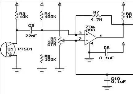

More complex crcuit than is needed but the front end gives ideas.
This (from above) plus an Arduino is about enough - or just the sensor with care.

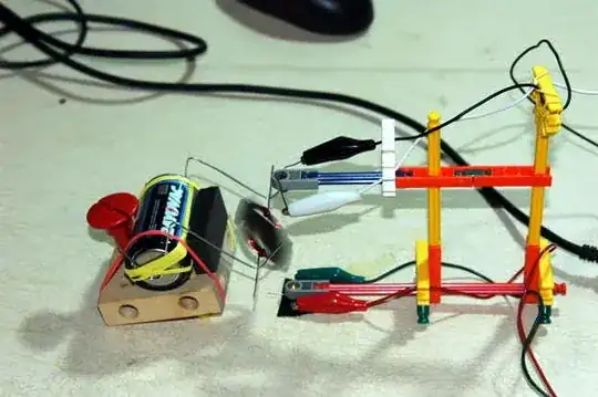

Arduino in the sky with clothespegs - actually a really simple optical interface optical tachometer with Arduino based optical tachometer with numerous clothes pegs assisting.

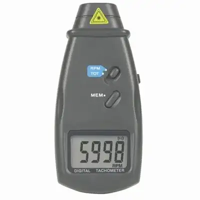

Sample of commercial unit - Australian seller $A80 rtail. I have one of these. Goes OK. No external interface. Hackable.
Identical unit at Farnell UK 43 GBP ;-(.
