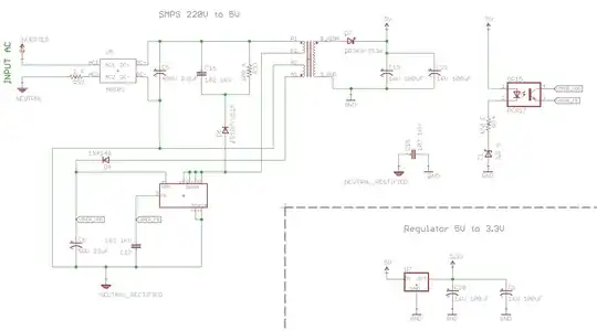

EDIT: Adding the schematic of power supply
SMPS power supply

  • I would put a MOV on AC line input and TVS at each MCU input. Also a series resitor and small cap before TVS is a good option, it will limit the rate of change of asignal thus TVS will react always at same knee point. – Marko Buršič Mar 16 '16 at 09:40
  • Thanks @Marko for the reply. Putting TVS diodes along with RC seems a little difficult due to less board space. Since total number of GPIO is over 20, it will take around 80-100 components (2 tvs diodes + R + C per line). Also, my IO lines are already optically isolated. So wouldn't it be an overkill? – Whiskeyjack Mar 16 '16 at 10:05
    I guess you have to redisgn the PSU, because if you have optoisolated inputs you shouldn't have such problems. So how do you power MCU and how the inputs/outputs, show the PSU section schematics. – Marko Buršič Mar 16 '16 at 10:36
As suspected you are using a single source to power MCU and input that are optoisolated. Now what's the point using opto's if it's all the same Vcc? 2nd What is a zener diode doing at hte opto input? Why isn't just simple resistor enough good? You have more possibilities:
1. Make a second secondary winding and new power source for supplying inputs (the best one)
2. Install a common mode choke, capacitors (PI filter) and TVS to power inputs
3. point 2. + remove opto's and instal RC + TVS, as the optos are useless if you use the same source.
What is going on? Your 5V wire that goes arrond your house is antenna like that picks up the noise and it transfers to MCU power supply. Extra your PSU laks the common mode choke at the input. See example: http://www.st.com/web/en/resource/technical/document/data_brief/CD00177969.pdf

  • Thanks for the answer Marco but I think there is a bit of confusion here. All this circuit is on the same PCB as the microcontroller part. SMPS part takes about 8cm X 1.5cm. This circuit has been derived from what you posted. I have removed the PI filter due to lack of space and there is a missing winding because I need only one output - 5V. My DC 5V is totally isolated. The Opto that you see is being used to give feedback to viper and zener is being used to set the feedback threshold so that I get 5V. (3.9V+0.7V = 4.6V ~ 5V). you can see a similar circuit in the app note that you posted. – Whiskeyjack Mar 16 '16 at 15:19
  • @Whiskeyjack I see, the opto is a feedback for voltage regulation, not the input to MCU. But where did you get the example for that feedbak, anyway? Isn't supposed to be there a voltage reference and couple of resistors and caps, not only one zener diode? Still the question persists is how do you power the optoisolated inputs? – Marko Buršič Mar 16 '16 at 15:33
  • Hey Marko, sorry for chiming in late. I was carrying out some experiments and this is the result: I used almost similar power supply circuit on another pcb to power up my microcontroller board and it's running fine till now. Now this suggests two possible cases: (a) smps circuit on same pcb is introducing too much noise due to less clearance. (b) I used a smaller transformer in on board smps which might be having higher leakage inductance and somehow messing up with the power lines at random times. what do you say? – Whiskeyjack Mar 19 '16 at 05:58
