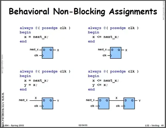

I have attached a slide of MIT OCV PowerPoint lecture, 2005, that clearly describe the difference between the two
Blocking vs non blocking assignment
You must understand the concept of RHL (Right Hand Side) calculation. Verilog always calculates the RHS and puts it into LHS. In blocking, the assignment happens exactly after the calculation is done, while in non-blocking, the assignment of RHS to LHS happens when the end of block is reached. That is why as 'the Photon' has mentioned for single lines both blocking and non-blocking will be the same but if you have more than one lines then things MIGHT change or might not change!
